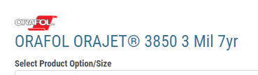

This is what I was going to purchase...it is white translucent...unless there's something else someone suggests?

I have a ecosolvent and use that 3850 with double pass and it looks good. Latex, I have no idea to be honest.
Have done the transparent on top with reverse on other side, need a light table and is a lot of work, so I stick with the 3850 since most businesses are only good for 3 years.
