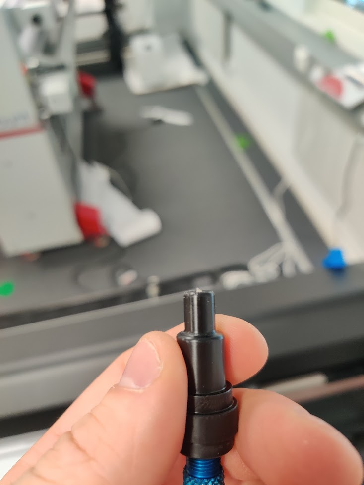

Blade depth:

It looks like the blade depth is fine and the material with laminate is less than 6 mil so theoretically this should be possible. Have you tried cutting the path twice, maybe with a lower pressure setting, to see how well that works on this material?

If I understand correctly, you are thru-cutting the media without using the flexcut option but with an high kiss-cutting pression.
The material tickness is:
Thickness vinyl + adhesive + release liner: 210μm
lamination with the same material (Thickness vinyl): 80μm
Total material tickness: 290μm
max depth for standard 36° knife is 250μm.
You must use a 60° knife (and in any case, using kiss.cutting to cut through media does not guarantee good cutting results)
