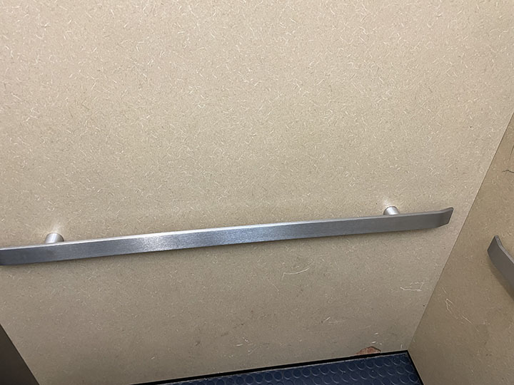

Hello all, I have a good client of mine who is asking me if I can wrap the interior walls of their elevator. The problem I'm having is I'm not sure how to remove the "hand rails" from the walls? There appears to be no obvious set screw, I've looked on all sides of the attachment legs. Anyone dealt with these before?

What are the elevator dimensions on that wall. It would reason that you will have seams. Perhaps you wrap it horizontally, hiding the seam under that rail, and notching the vinyl at the bracket to wall sections?

I'd never wrap one with regular vinyl... It's not srong enough to handle elevator usage. A thicker interior vinyl like Dinoc or it's equivalent is good. You can butt seam it without it being noticeable too.
Usually there's a set screw / grub screw on the bottom of the elevator handles right where it connects to the wall.... You loosen both, pull the handle off and then unscrew the bases from the wall... At least the ones we've done are like that.

Some elevator wall handles are mounted from back side with screws then hung / installed panel as a whole side panel.

Is there a screw head underneath the cylinders that attach it to the wall? What do those supports look like from underneath?
