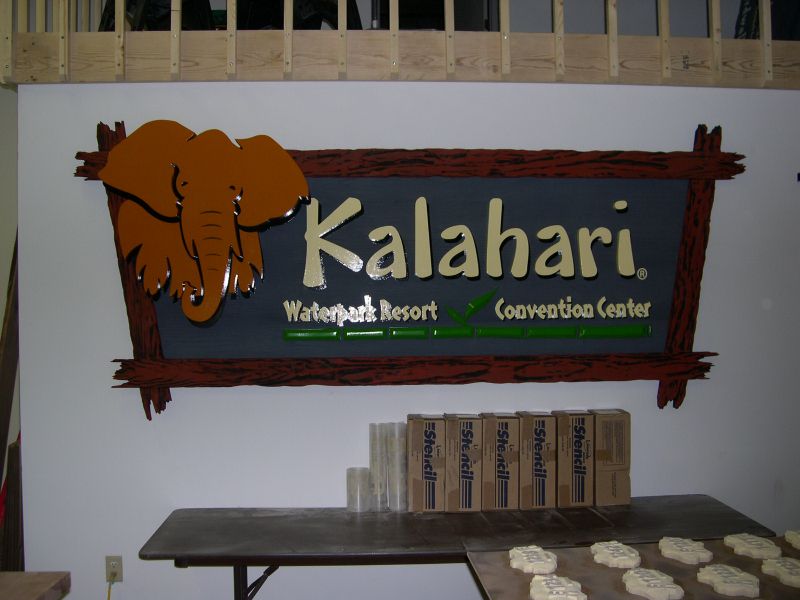

Just starting to finish some of the exterior signs for the next project.this is a 10' flat grain sandblasted redwood panel with 1.5" foam main copy and .75"router cut foam sub copy.the bamboo is also foam prizmatic cut and then sanded.The elephant is 2" foam and mounted on mdo,studed off the panel 1.5". The frame is 5/4 redwood sandblasted and stained.The colors and logo were done by the customer(The font and the elephant)we just tried to make it a little better.
