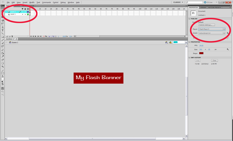

When your design work on your banner is complete, follow these steps to implement the clickTAG button.
1. Right click on Layer 1 (or your topmost layer) and then click on Insert Layer as shown in the screenshot below.

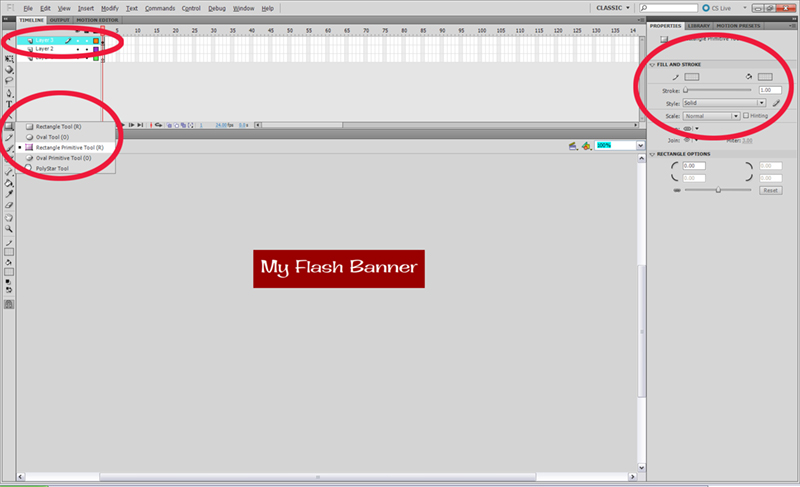

2. Select the Rectangle Primitive Tool from the toolbar as shown in the screenshot below. Draw a rectangle of the same size on top of your banner in the New Layer that you just created. Then use the rectangle properties view to change both the Stroke Color and Fill Color to white and set their Opacity to 0%. Doing this will make your rectangle completely transparent as shown in the screenshot below.

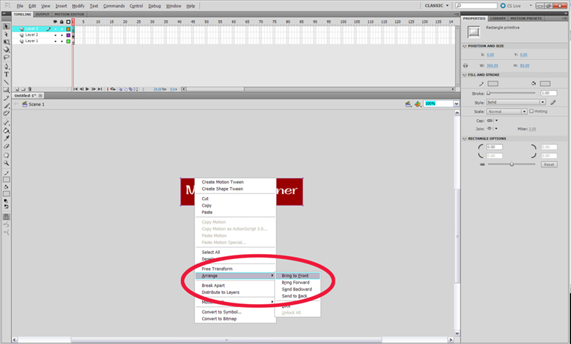

3. Right click on your transparent rectangle and then click on Arrange > Bring to Front as shown in the screenshot below.

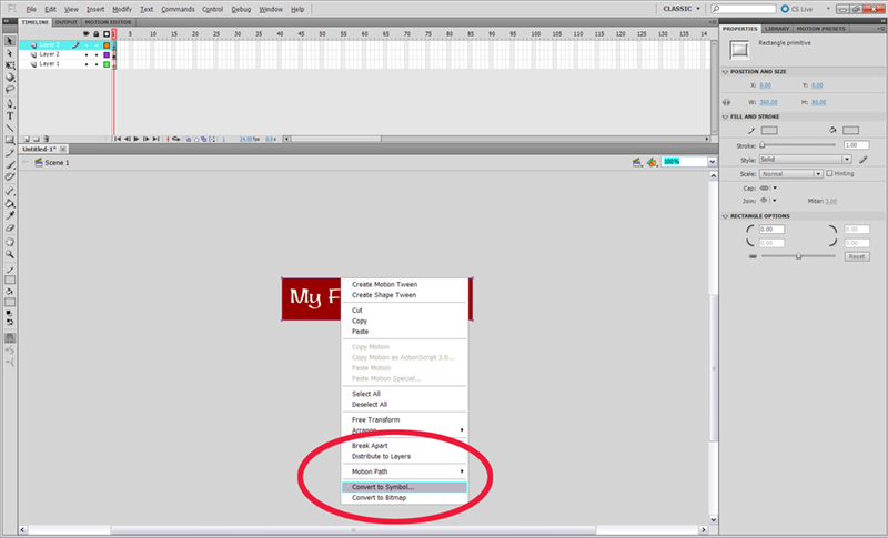

4. Right click on your transparent rectangle again and then click on Convert to Symbol... as shown in the screenshot below.

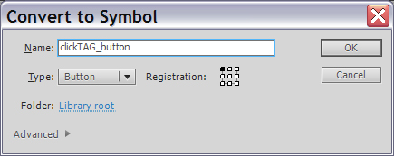

5. Enter clickTAG_button for the name of the button as shown in the screenshot below.

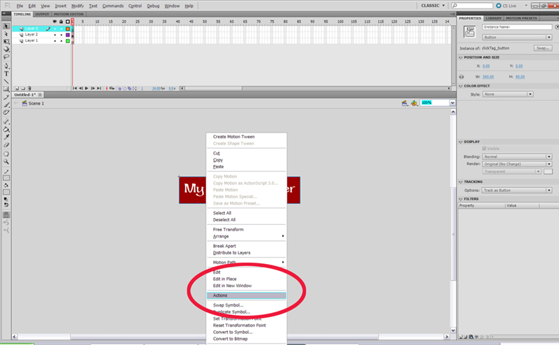

6. Right click on your rectangle, which is now a button, again and then click on Actions as shown in the screenshot below.

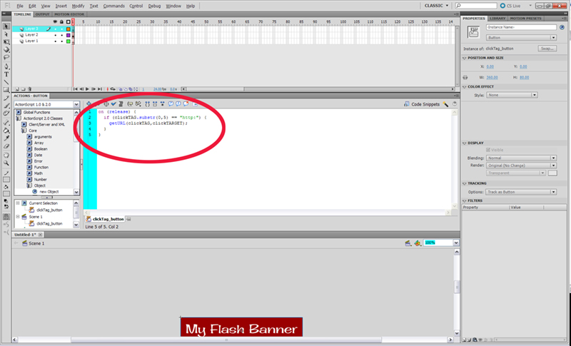

7. Copy the ActionScript code below and paste it into the ActionScript form field. Do not make any modifications to the code! It requires absolutely no changes to function correctly. It should be copied exactly as it appears. Here's the code again:
Code:
on (release) {
if (clickTAG.substr(0,5) == "http:") {
getURL(clickTAG,clickTARGET);
That's it! Please insure that you have set you publish settings to Flash Player 9 and ActionScript 2.0 and save your Flash FLA file. Finally, click on the File menu and select Export > Export Movie. At this point, you may email us the SWF movie along with your desired URL landing page.
