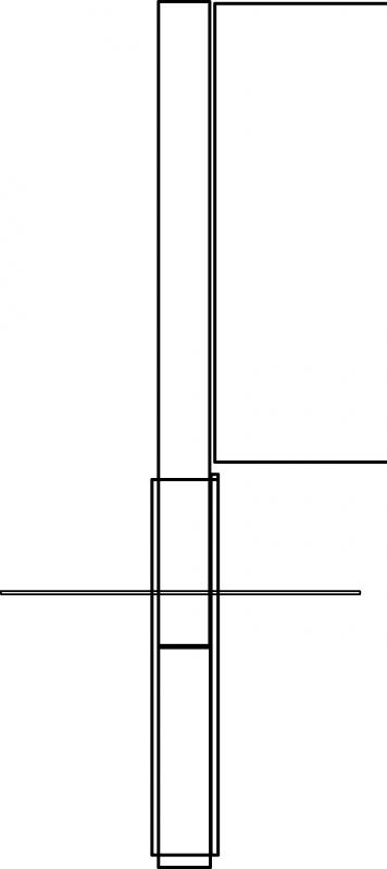

Most of the lumber yards around here have 10' 4x4 PT, hard to believe there's not a place in your area with them.
But in any case another option is to scab two 4x4s together with some 1x PT decking and create a skirt for the the first foot or two out of the ground.
Some gorilla glue and scews and it will solid.
Your measurements are a little off. If this is to remain in the ground for any period of time, especially where you're located, you should go down 38" to 42" into the ground and pack very hard if not using cement. With these calculations, that would put your sign underground. If using cement, you should go double the depth of your frost line to be safe. Otherwise movement of the earth, rain, snow and wind will raise that thing out of the ground in no time.
