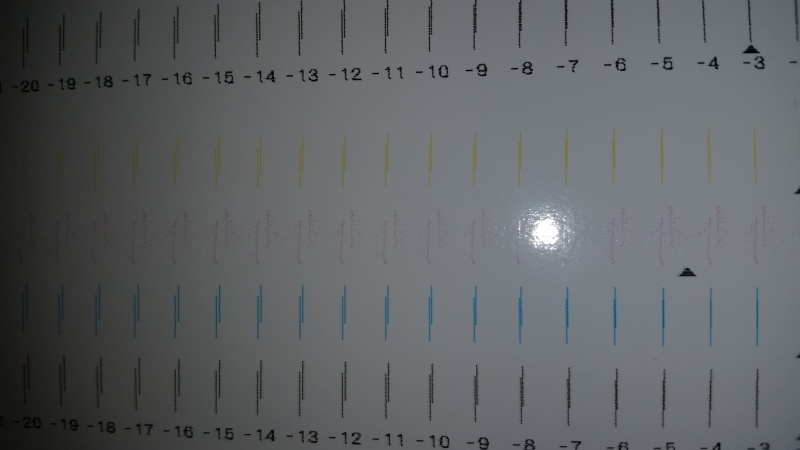

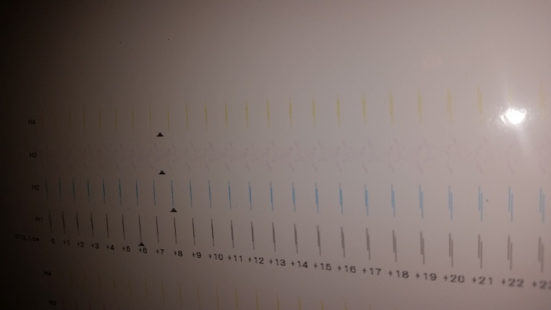

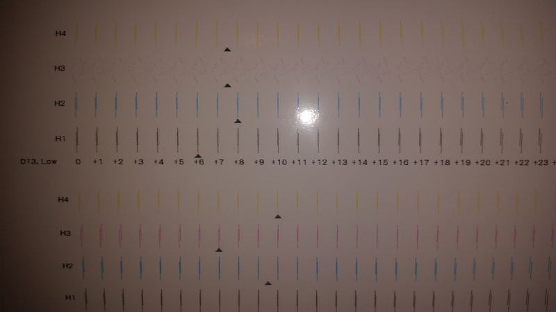

Cap tops replaced again, new dampers fitted but still getting this problem on DT3....

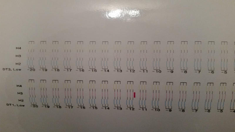

Can anyone tell me what the DT3 is? DT1 looks fine but DT3 is AWOL!

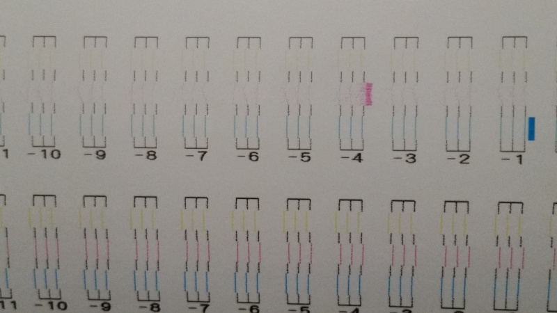

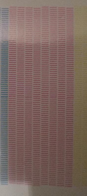

Getting a ghosting of magenta around everything....
Hey Scotty!so this can happen when you are reseating new print cables. There are 2 that go to the headboard. I would take them out. Make sure there is no Kinks or dirt or any sort of contaminate on the connection of the ribbon. Then I would reseat them good and flush make sure again not to kink them when putting it back in. I would try that. I know those things are big cry babies.
Let me know hope it works.
No luck mate, took the strip out and gave it a good clean, checked/removed all cables and still the same
