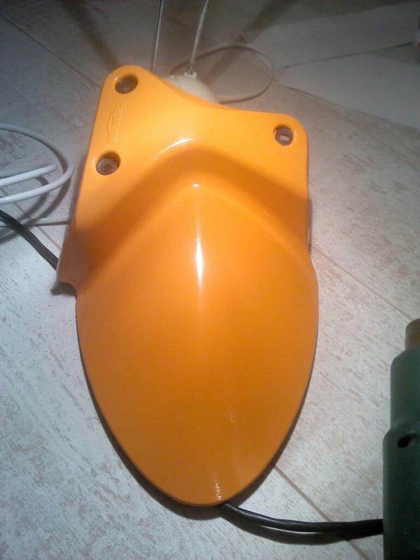

I just did a rear-fender, which took up to 1.5 hours with the thicker material. and it went really quick with the 3m vinyl.
Is it perhaps the thinness of the material? Easier to get wrinkles if you don't keep the vinyl apart from eachother.
I have lots of build up of material on more advanced contours., where im just working on getting the vinyl straight again, instead of applying it.
on the fender its perfect, on the rearpiece with the difficult contour i threw away 2 pieces already.
