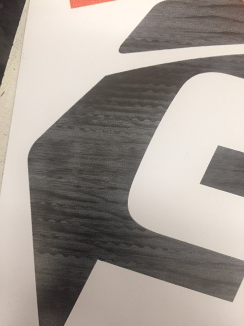

Has anyone had their 1204 do this?(see attached) It's fine if I do a clean with sm ink fill before printing. Does not matter the profile and does it for all colors on left end of the sheet.

I have seen this type of issue before where it only drops out on the left side of the print and it ended up being the manifold was clogged and restricting ink flow. You could take the manifold off and flush it but that can be time consuming and it could also damage the head if you aren't careful. You could also try running a long store cycle. This will empty the machine of ink, flush it out with cleaning cartridges and then you can fill it back up. This is the more expensive option but it is safer then flushing the manifold.
Also, you should change the dampers to rule them out.
rrd
It has new dampers, new head, new maintenance station and new cables. Started about week into the new head. My outdoor jr has gone 12 years with less issues haha.
