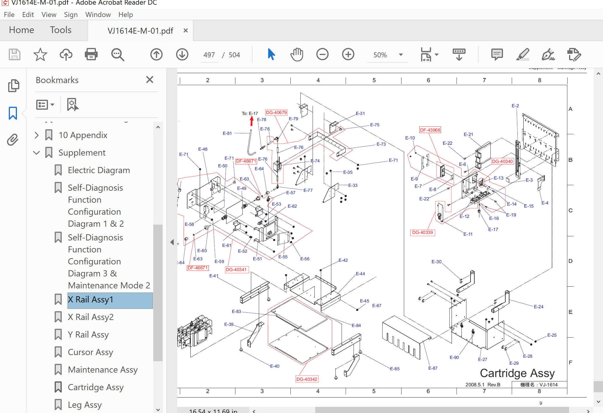

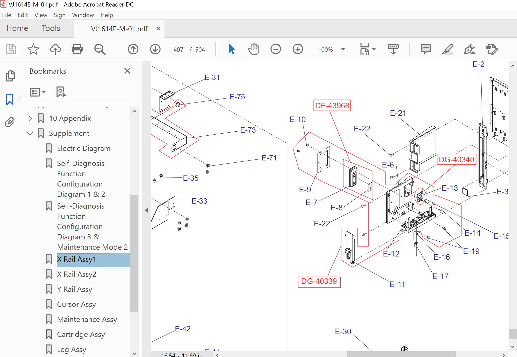

The Ink End Sensor is the part labelled E-13 on the attached screenshots
