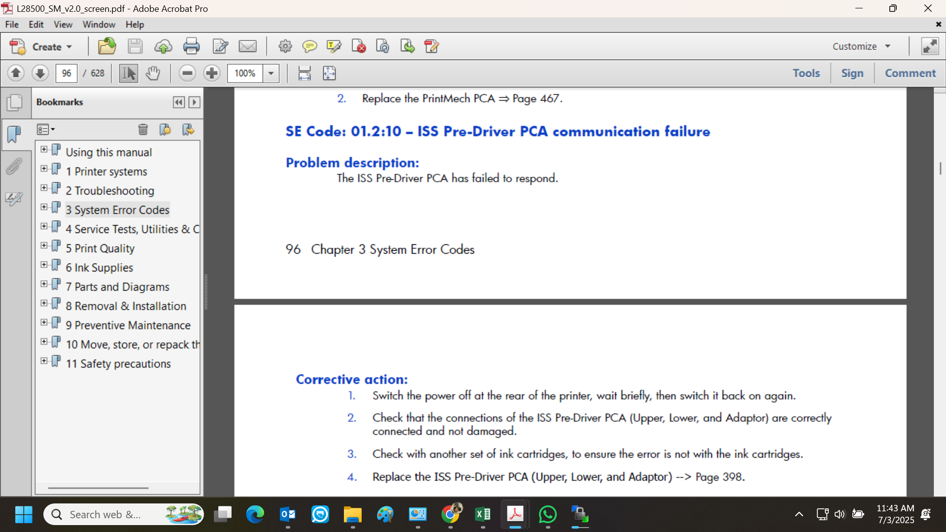

How did you end up figuring "trailing cable or the PCA" when it's pointing to the ISS??
Could be loose connection from the previous repairs or ink leakage etc.

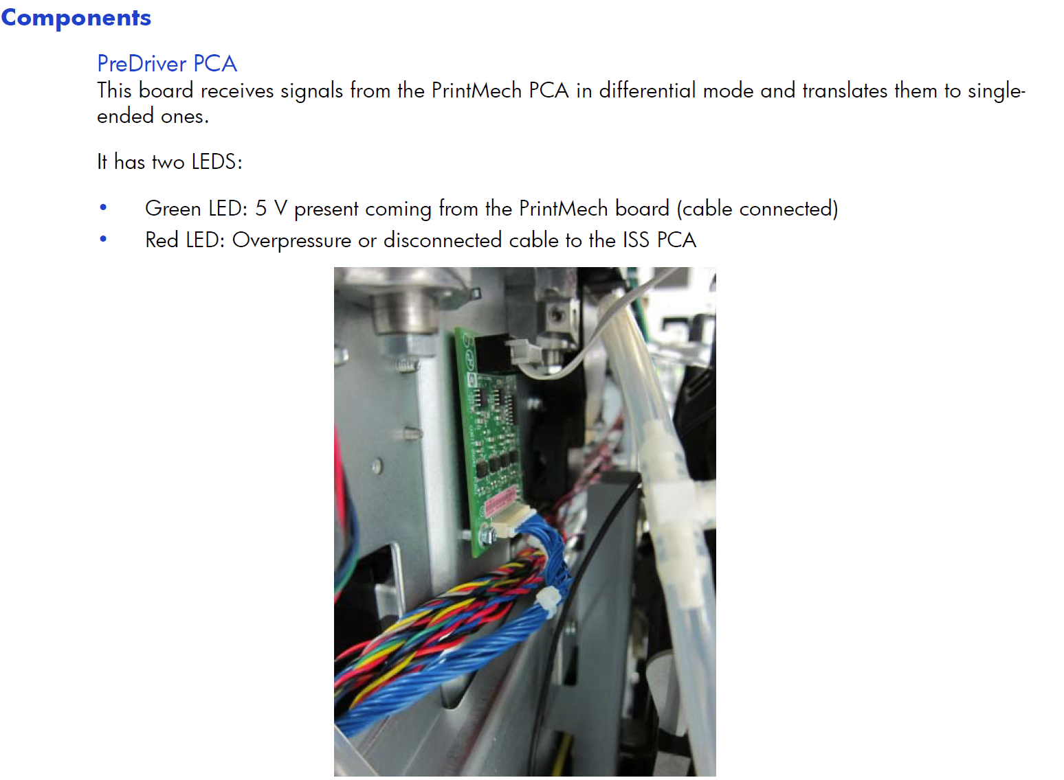

fair enough after checking all connections.. and the cable.. I restarted..
and it now DOES throw the 01:02:10 error.. lol.. I am pretty sure it was the other one first..
but never the less.. I put in new cartrdiges.. same.
MonsterBabyBLN
ok:
so I saw it stoped the initializing process at 37%.. all LEDs were on but the lower one for the 24V supply on the PrintMech..
I replaced the 24V power unit.
same
I replaced the main power unit.
same.
I replaced the printMech.
it booted up all the way.. and then beeped with the same 1:2:10 error..
is this strange that the error always occurs at a different stage?
MonsterBabyBLN
just did. same 1.2:10 pops up.
I did start the service menu .. and as soon as I go into the Ink sub menu.. test inks.. the error pops up
I might have to replace the whole system ?
