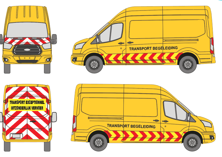

Now it doesn't have to be 3M diamond grade but it must be reflective. Red/White striping in front and back. At the sides Red/Yellow.
It's for a vehicle that drives in front of an exceptoinnel transport.
PhilipPrinting
Something like this

PhilipPrinting
Missing a bit of information on what you are doing, but quick tip is you can apply reflective vinyl onto a wrap vinyl (like Arlon Cast Wrap SLX) to make it easier to apply onto the contours of a vehicle.
Great idea... Don't know if this keeps the foil in good shape?
signheremd
We have done used this on Fire Trucks to take around front curves and on the back of other vehicles, like Fire Police and other government vehicles, to conform to convex curves. It does help with preventing crease marks in the reflective. Now to do something like that frontend of the van, I would use Arlon IllumiNITE Wrap + Flite Technology (a printable reflective wrap vinyl). As always with reflective, watch bending it back when removing the wax paper as sharply bending can leave an indelible mark in the reflective.
