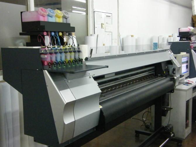

Most users useing this CISS.
cartridges with float can pretect the ink current without air.
Adam Yang from Inkmed
