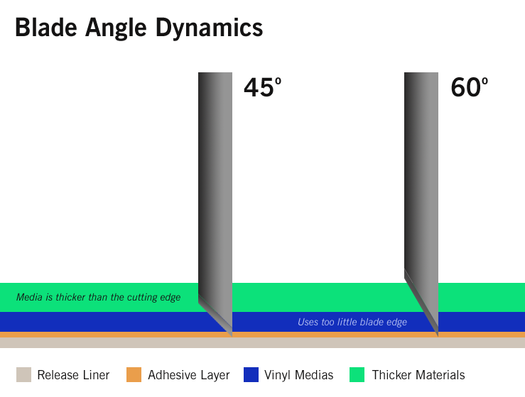

IMO, blade angle is for thinner vs thicker material.
ams
Yeah I think the 60 is designed for things such as Multi-Lens vinyl which is mega thick.
