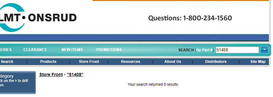

Also I use high quality Vortex tools, sharp ( new in fact)
I do not find your tool, can you help?
