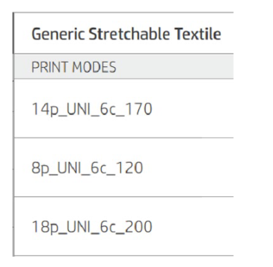

I opened that 18p stretchable preset in SAi PM, and it only goes up to 600dpi... Do you think this is just a RIP software problem?
The 'dpi' referenced in the RIP is not the resolution that the printer is printing at. It is the resolution of the raster data set that the RIP generates and sends to the printer. The printer converts the pixel information into 'dots' at a higher print resolution. For most print modes this is 1200x600 dpi.
Alpha Star
Thank you! Is this one 1200 x 1200? Referring to the 18p6c200 found within the stretchable textile media.
