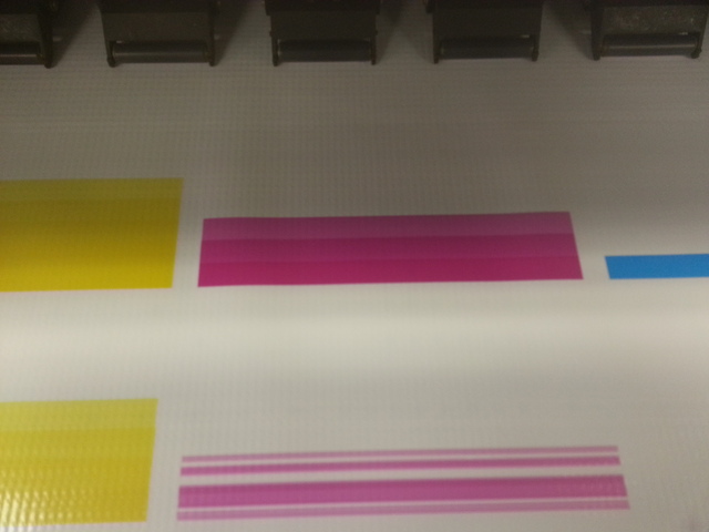

I'm printing a banner that consists of mostly magenta, after about 9 feet the magenta started to band. I double checked the heater settings and they were all correct according to the manual. Afterwards I did an IQ Test Print and the banding was still there. About an hour later I cleaned print heads and did another test print and the banding went away. Anyone have experience with this?
Pics below.

no need to replace the head, YET...
you most likely have ink starvation, caused by a weakening damper, or a slight air leak above the head

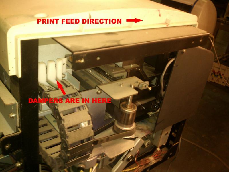

OK here it is with the side panel off -- capping station side - looking from rear to front
they are a pain to get to, but no need to unplug any wires in there (DO turn off, unplug printer, and press power a few times to get rid of any latent power in the capacitors)

The 9000 does have dampers and they reside ontop of the carriage under a couple layers of fun. They do go, but not often.
