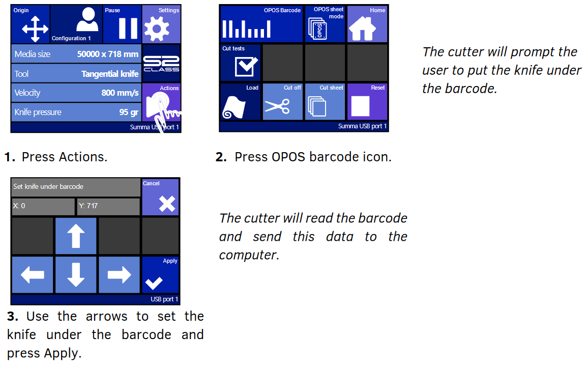

Anyway, all of that is not really what this post is about, and I'll keep working with it. My main reason for posting was regarding the barcode reader. I have gone through the steps of getting my activation code from Summa and then executing the barcode server in Cutter Control. However, when I go to the area on the summa control panel where the barcode reader should be listed so that it can be activated, there's nothing there. The only thing listed is the GPerformance Mode activation block. There is no barcode block on there. I had thought all the S2's had this option built in? I had seen videos from back in 2014 on cutters older than this, running a barcode server, and looking at the Summa site, I thought it said this function was integrated into all S2 models. I could be completely wrong, but wanted to check here first.
GivenToFly
Have you followed these steps? https://www.summa.com/en-us/blog/vinyl-cutters-how-to-set-up-an-automatic-print-and-cut-workflow/
Also, is your cutter control and firmware up to date?
Yes, I've registered, downloaded the activation file, and had the activation code saved as well. The next step after that is to go into the Summa cutter control panel and into the Actions menu, which is where the Barcode option should be, but it's not. And I updated about a month ago to the latest firmware.

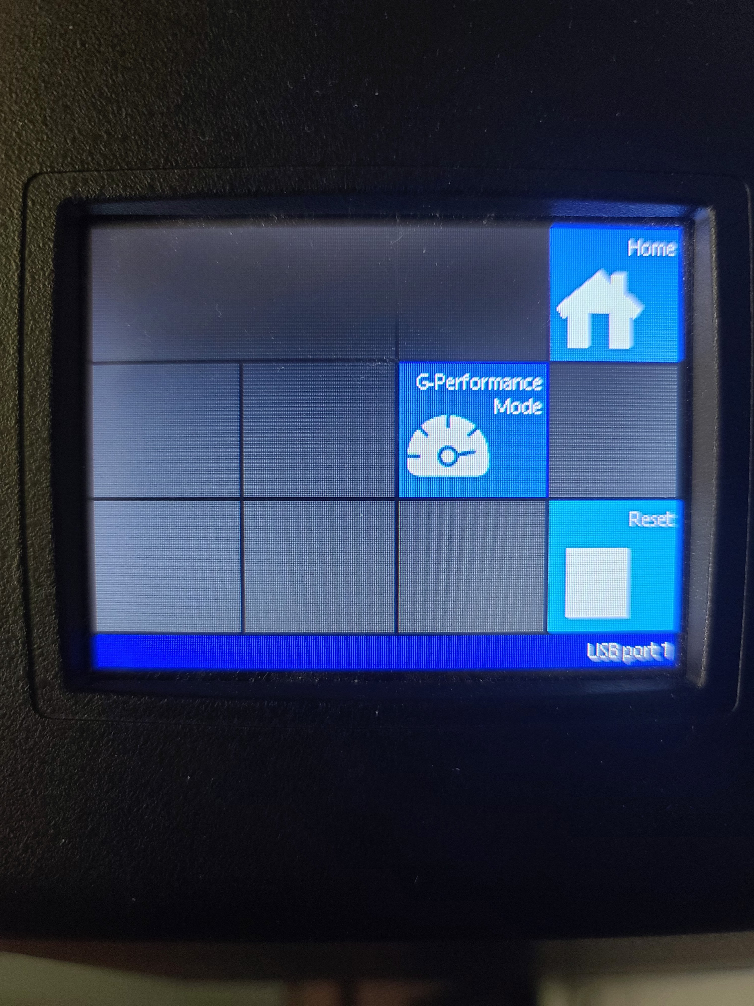

Thanks. Yeah, my problem is I don't have the option on that G-Performance screen to actually activate the barcode feature. From the home screen I'm supposed to select Actions...and that takes me to the screen with the G-Performance icon...which is another feature that can be activated. From what I've read...on that screen I should have the activate barcode option, and once I select that, I am supposed to input a code that I was given. But I don't have anything about the barcode displaying there.
On your multiple cuts, are you just setting multiple kiss cut layers in the artwork so that it passes over each one two or three times during one cut process? Or are you sending the same cut job to the cutter as a kiss cut two or three times? I feel like running two kiss cut passes and adding just a little more pressure my help my issues, because the kiss cuts come out amazing. I've watched videos of people running their Graphtec FC9000's and it is seriously making me contemplate selling this Summa and going that route just because of the ease of cutting decals, which is what I do the most.
The reason I was asking about your firmware is if you accidentally installed the firmware from a S1 and not an S2 this can happen. So of it is not an MD9981.025 then I would reinstall. If it is, then you need to contact summa as something may need to be added to the machine like the g performance on the older machines.
GivenToFly
Yeah, it's definitely the S2 firmware that I have installed. Thank you for the input.
