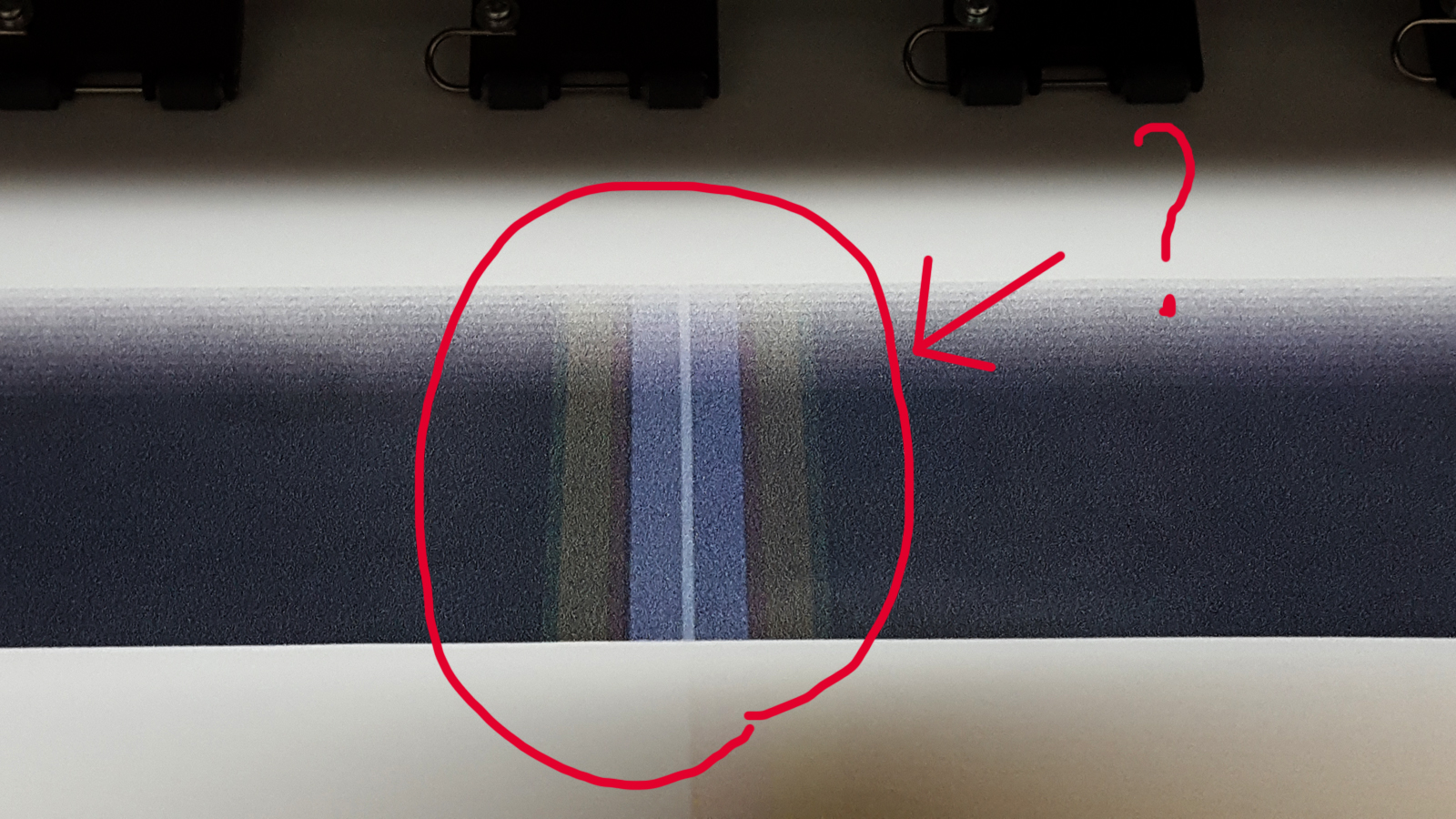

Hello,
does anyone know this problem?

Does the defect happen in the same spot on the printer on every job? I would clean the encoder strip first just to rule it out. After that you could have a bad cables anywhere from the head back to the main board. If it's not a cable it has to be the head or the main board.

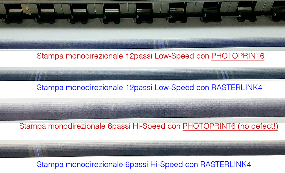

Thanks for the quick answer,
The encoder has been cleaned, the strip moves according to the resolution, steps 6,12, 24 uni and bi-directional and the printing speed (see attached photo) considers that I have changed head F186000 lock, and the printer firmware is 2.20.

It could be the print head since it's one of the locked ones. I haven't put one in a MImaki yet but the issue you are having looks similar to when you put a locked head in a Mutoh.
