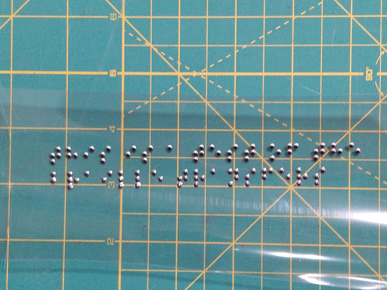

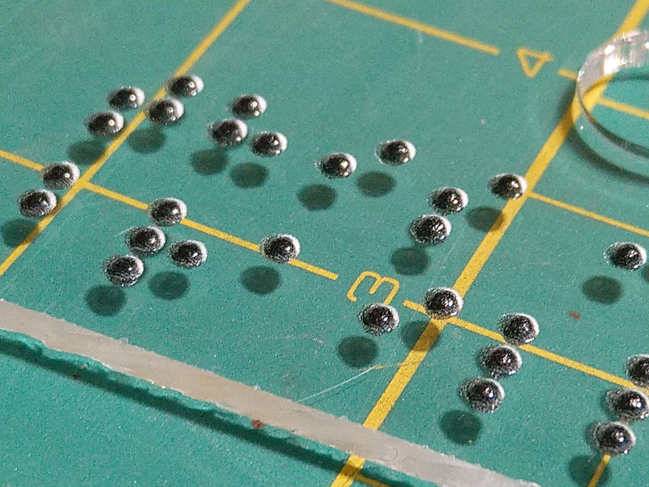

Playing around with decent speed printable braille transfers that meet ADA compliance and can be done with a $3k printer. No flatbed needed, small foot printer using 3 dirt cheap XP600 heads. Nice thing is it lets me print huge gang sheets of the things where needed. Wondering if there is much of a market for such a thing, or it's monopolized already?
Managed to get heights up to 1mm and can do dot diameters as small as 1mm with .5mm height. Adhesive is more durable than some UV cured application systems, no special materials and ink-jettable UV epoxy that runs about $60/liter.
Still playing with compensation and alignment for printing on semi-spheres, would be cool to offer colored or even designs printed in the dots themselves in the future. Lots of maths tho.

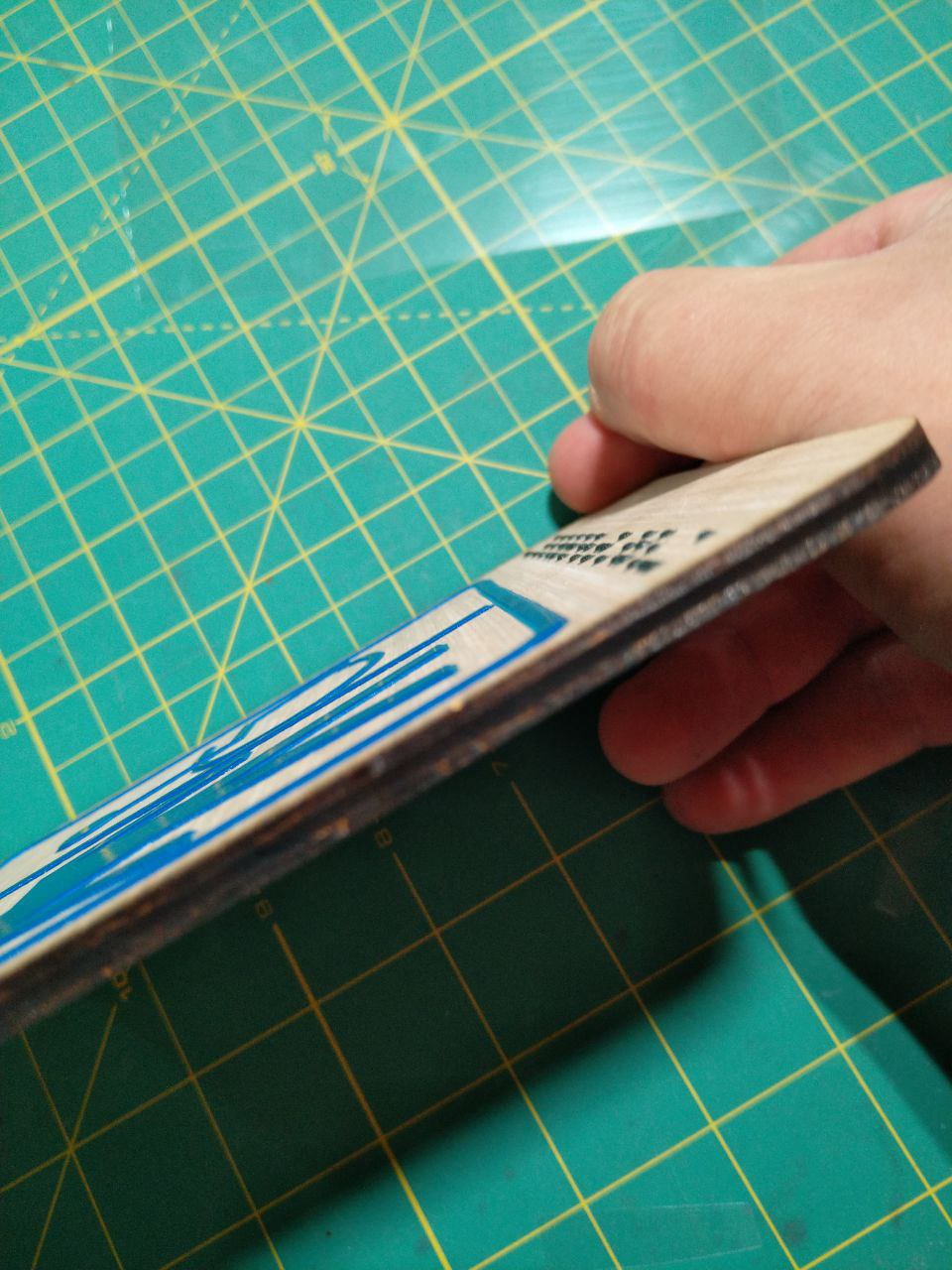

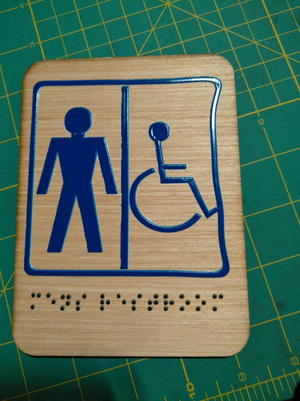

Here we go, full raised sign stuff. Need to tweak the ink a bit to keep the creep at bay. Printed to a transfer and applied to wood, not printed directly.
  • Love
Smoke_Jaguar
Modified ink and adhesive, modded printer as well to get the height required. Asides from the higher head gap and extra heads (4 6 channel TX800 heads), messed with the bidirectional calculations to adjust to higher pass counts. Also had to stack some more UV lamps in.
