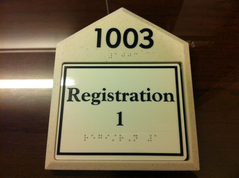

Moze
All numbers and text require braille. The braille has to be under the corresponding numbers or text.
Rick
The sign MOZE is showing is somewhat deceiving
The room number on his sample probably should be raised numbers with braille.
The "Registration 1" does not need to be raised or require braille if the number is complaint. If it was required to be ADA compliant, "REGISTRATION 1" would be all caps.
