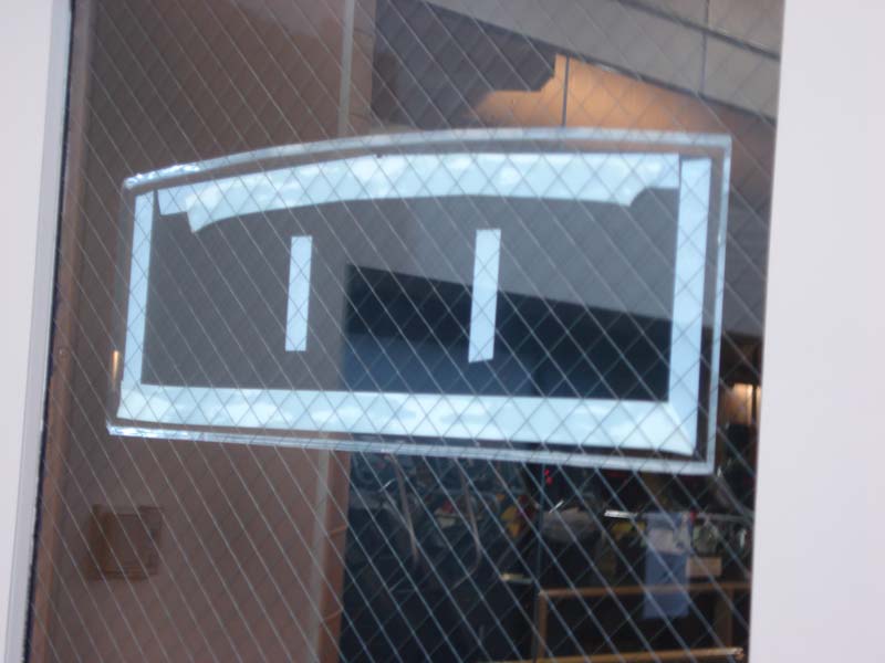

I had to show this, this is from a high end apartment property at the fitness center somewhere in Minnesota. As you can see, lazy install... it should be obvious, use a backer or at least a clear tape, I see this a lot.
It also doesn't look like they wet it out very good.
