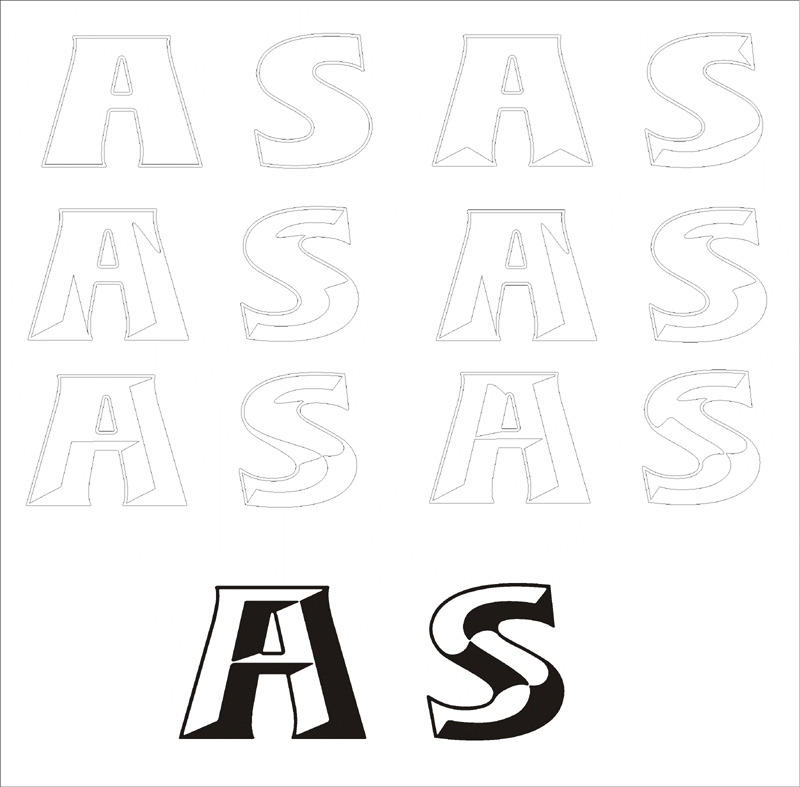

Steve C.
I find my method simpler, others may not agree. I start with an inline
contour of the letters, then manipulate the control points to form the chisel.
I don’t pay much attention to precise centering of the lines, I just do it
optically. Sometimes mathematical measurements don’t look right. This method also keeps all chisel shapes as one piece for easier weeding.
For gradiants, one easy way is to create a fill from dark to light on the base
and then just flip it on the chesel part.
sorry, the third step is shown twice. but you get the idea.....
