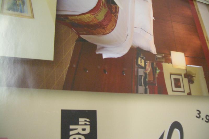

I have a print that got some trapped air bubbles in it. I have used exacto blade and pressure, but no good you can still see the bubbles. I even let it sit out overnight. Does anyone have a suggestion on how to remove them? I am on a tight deadline with a stickler for a customer. See attached photo along the dresser image.
WrapperX
Even after using a needle and a squeege and even running it through the laminator again have I ever fully removed the remence of air bubbles in lamintate. My guess is because the laminate stretches ever so slightly when the air is trapped and it doesn't shrink back to shape as well as vinyl does. You can try heat, but if the customer is a stickler, you're unfortunate safe bet is to just go ahead and reprint.
