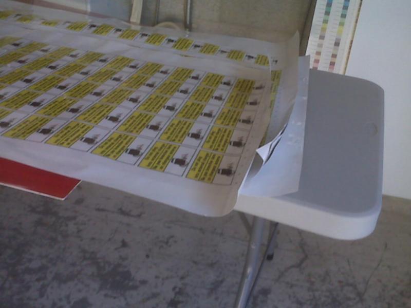

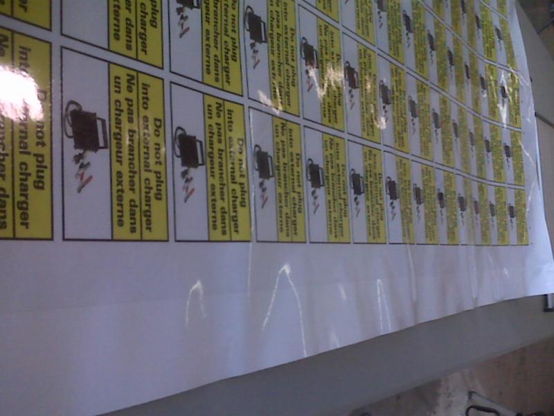

Here look at these two pics. This was a new material promoted to me as having 90lb backing liner.....not. Yesterday it was a bit humid and rained a bit but I have never seen digital vinyl do this. Was a nightmare to laminate as the liner seemed to absorb far to much moisture.
The vinyl I regularly use was perfect with no such waves and curling

I've only seen that happen with regular (cutting) vinyl that was printed on.
Specifically, the GFI 501 series vinyl vs. the GFI 200 series vinyl.
