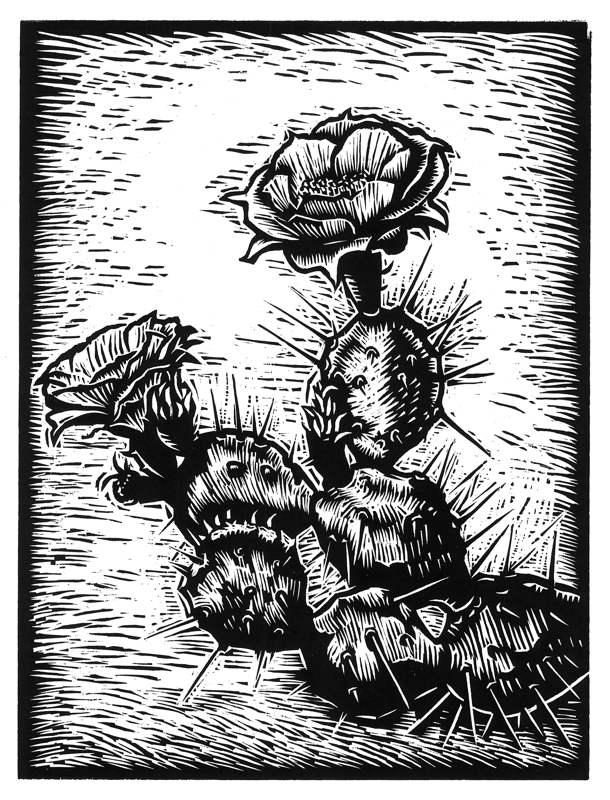

The first picture is the original image of the artwork we had to work from. They were bitmap .jpg's and need to be converted to vector line art for the laser engraving.

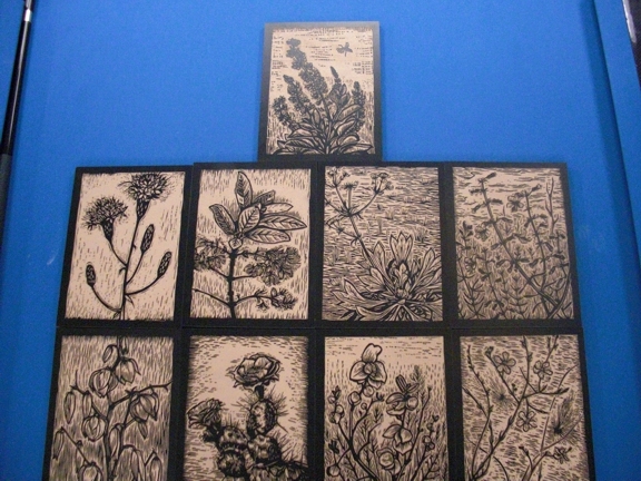

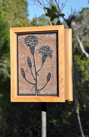

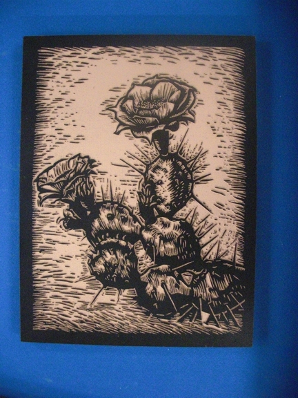

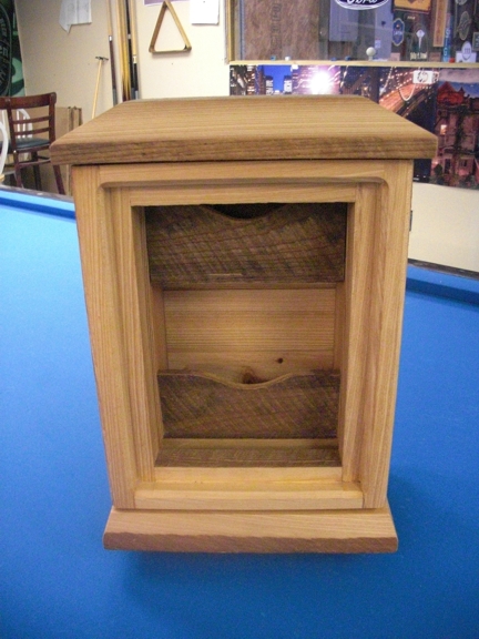

The second photo is the finished result after the carving and painting. The third image is a shot of all nine designs, along with the shrine box set up on a galvanized pipe that these were installed in. The pieces are very small and the artwork details even smaller. Looks like a simple job, but in actuality, it was more work then even I was expecting. That's what happens when you challenge yourself with the unknown. But believe you me, you sure do learn a lot in the process.
