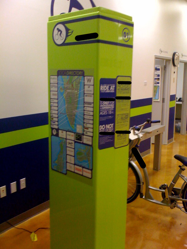

How are you getting the wrap material off now. If the old wrap is not taking the paint off I doubt that the tedlar will.
here is the sample...
BigfishDM
Merchant Member
Yeah looks like it wont be a problem to do this, they just want to make an exsisting kiosk graffitti resistant or are you printing out the whole graphic for them?
