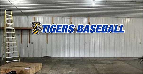

Any tips on installing on grooved metal walls
Stacey K
I like making signs
4 - 48" circles that are printed
1 - "C" printed
1 - TIGERS BASEBALL, 21" TALL
What kind of vinyl would be easiest to work with for the wording? Would it be easier if I printed and laminated it so it's a little thicker?
I'm mostly worried about the words...any tips? Thank you!

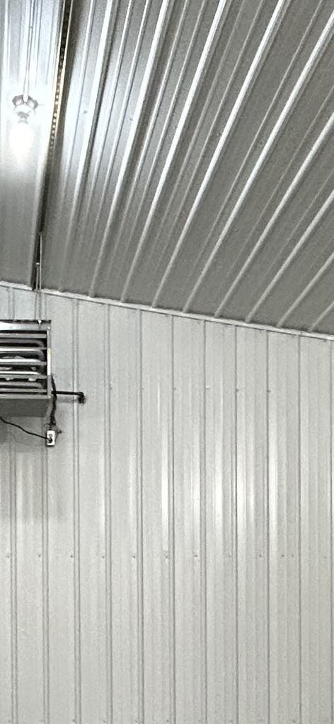

Do you have a clearer picture of the wall's shape? I was imagining old school corrugated tin (got that on the brain from a job we are working on currently), this is obviously not. If the dips aren't too deep, you may not need to. I think DL just did a roll up door that looks a lot like this paneling...
danno
Negative Ghost Rider, the pattern is full.

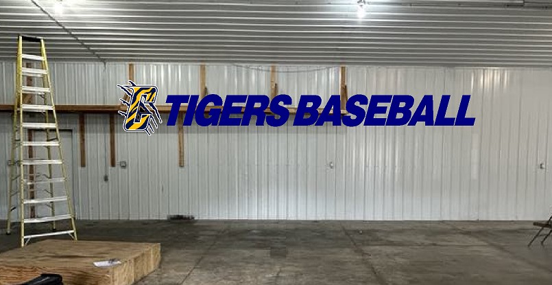

They might get hit with baseballs that's why we opted away from PVC and aluminum. He made an indoor batting field and has nets hanging up that will be in front of the walls. This is the best one I have...

Ah, I'd opt for lexan/polycarbonate, clear, with graphics on the back. They can drive homers at that until the... tigers come home and it shouldn't hurt in the least.
Otherwise yes, it looks like you'd want primer on those particularly steep troughs. Also, every seam in the metal should be cut in the vinyl, otherwise it will tent and buckle when summer hits.

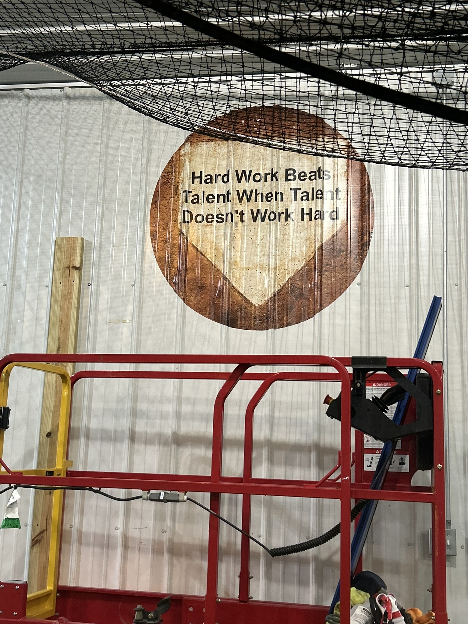

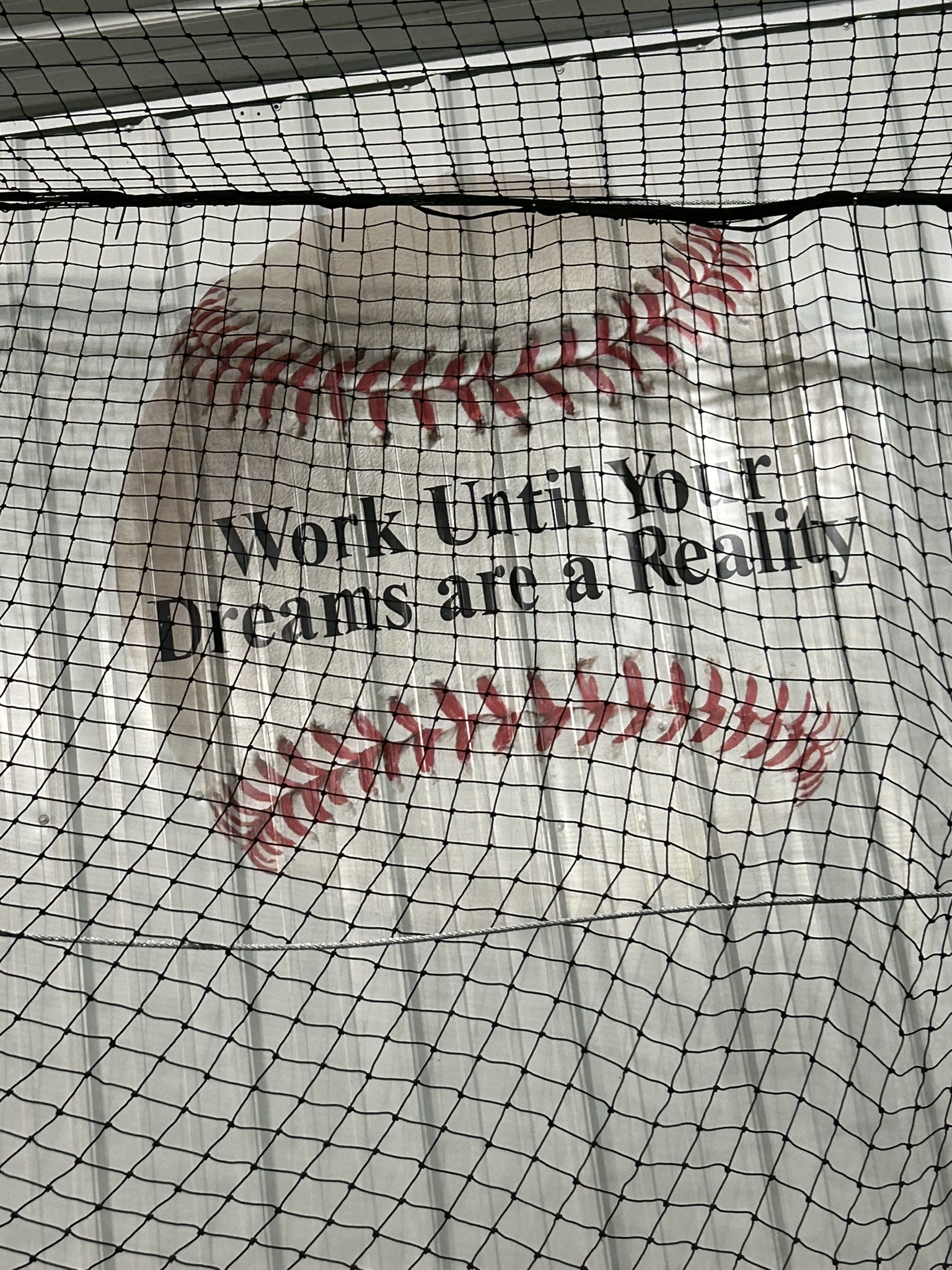

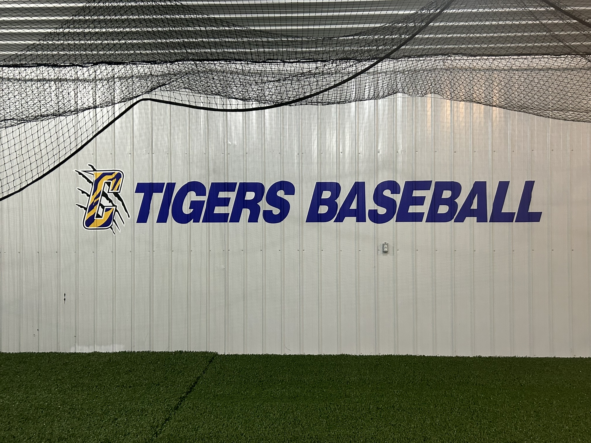

Got this job done Thursday and Friday. Used 180c/lam with primer. I did cut some of the edges of the raised areas.
It went OK but a major PITA and tedious. The worst part was I was using a lift and the circles were 47" so I used my Big Squeegee to get the center started then worked out. It was HOT and humid 10' in the air and I was soaked with sweat by the time I was done both days. My hair clip kept getting caught in the net that was hanging down. Every time I moved the lift I had to grab the net - miserable. I had to move around to catch the light to see if there were bubbles - and with the deep areas it was a lot of moving around.
I will not do this again. There are easier ways to make money. These kinds of jobs are crappy but tolerable - but when you add the working conditions into it - it's just not worth it.
4 circles were 10' up the wall. The logo/words I could use a step stool so not as bad.
Looks great! When you say you cut some edges, you cut the parts of vinyl overlapping the metal seams right? From the sound of things, it's not insulated, so it will be expanding and contracting with temp changes.
Stacey K
I like making signs
Thanks! yes - where the seams are and then there were a couple spots where I cut vertically because of the bubble situation. Using the Big S. was a bit difficult no matter how slow I went. They are all behind nets so even with contraction I don't think you will notice.
