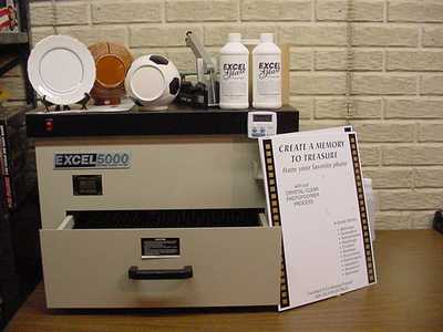

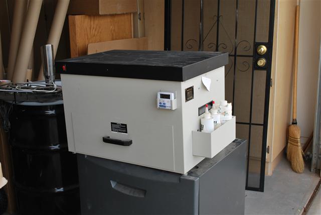

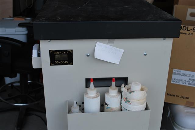

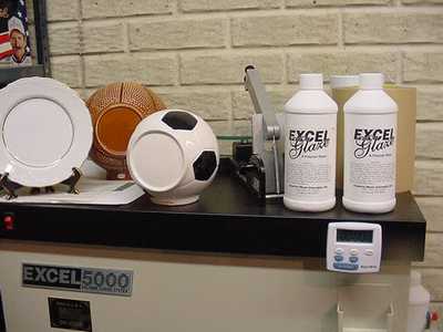

How big is the 5000?
jiarby
click that link in the post for details... here are a few pix..

digitalwoodshop
How much are you looking for?
What size is the inside drawer area?
What is the UV source? What is the bulb number? How many?
They sell UV Glasses and the bulb is $180.00 so this is serious UV....
I am currently doing it with a set of 3 black light tubes from Home Depot....
There are times I wish I had a QUICK Cure Oven.....
