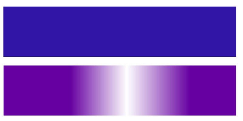

The 1st problems happens all the time and it seems that when I use a gradient fill - in this example, I have 100% Violet C fading to White.
The problem is - the shade is way off than if I just print solid Violet C.
In this screenshot, the top is a solid fill of Violet C. The bottom is the same color with a gradient to white. What is causing this difference in the color?

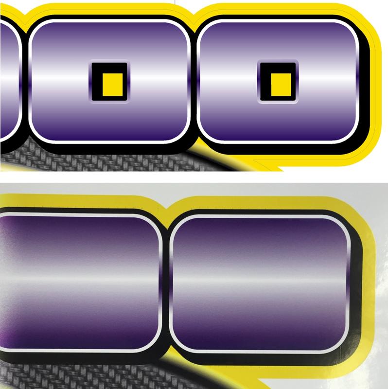

The second problem is totally random but seems to happen more often when using gradients.
The top part is a screenshot of what I am trying to print, the bottom is a photo of the actual output. What would cause the object to not print as shown?
I remedy the problem by rasterizing the graphic with a transparent background, but that is a pain. Also - since it is random, I usually do not realize it happens till after wasting a print.

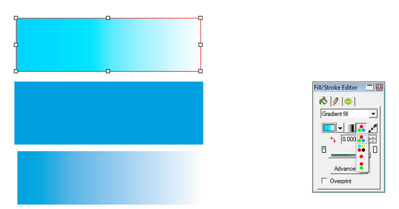

I had that issue too, till I figured out why. When you select the Gradient fill, be sure to drop down in the little menu with the R-G-B and make sure you select the C-M-Y-K....then it will display correctly. See my screen grab here...the middle is solid blue PMS 299....the top is 299 to white in RGB, the bottom is 299 to white in CMYK. It is the correct color.
