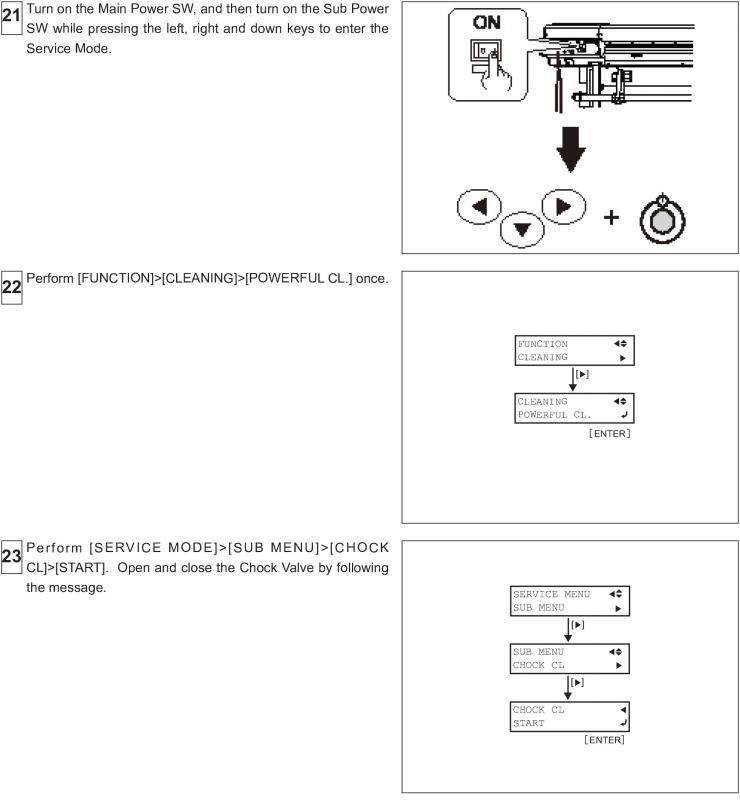

Hey guys, I have a new head on the way for our VS-540. I have no problem with the mechanical aspect of swapping the head, it's very straight forward on this machine but I'm wondering if anyone has a write-up or walkthrough as far as flushing the lines, filling the new head, if cleaning cartridges are needed, etc. Basically I can get the head in but I want to make sure everything else is done the best way possible. Thanks everyone!!:thumb:

After replaced the head
