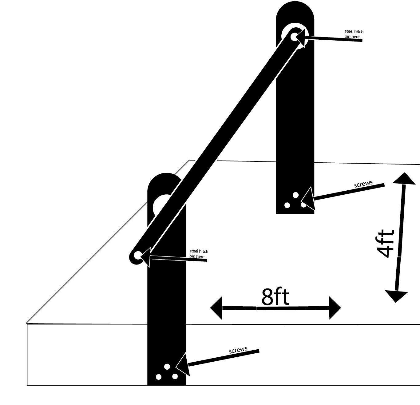

the table is 4 x8 long. I had one of these a neighbor made me and during a move I lose one of the sides. Its so I can rollout transfer table and squeegee it on easily..
is there an actual name for these things? also, it would be nice to have 2 instead of one if possible.
I did my best to draw it, the pole is approx 4.6 feet long with a couple inches on each side and a hole drilled out to put hitch pins in the the vinyl does fall off the roll.

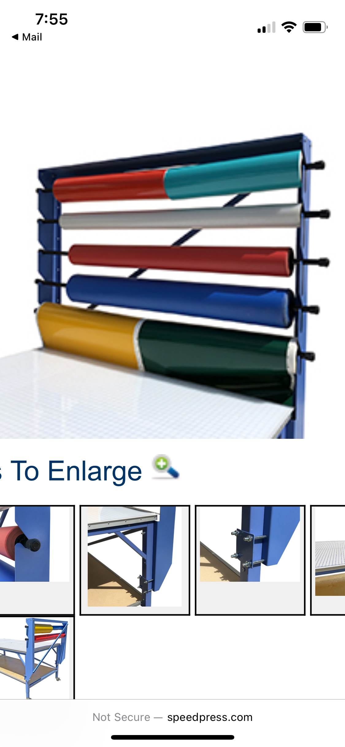

id rather not modify a wall rack to make what im looking for, I feel like ive seen them at some shops ive been to throughout my years..... mockup vinyl holder.png

Don't know what they're called, but pretty much every shop I've ever been in has had one- usually "home made". A Google search of "transfer tape dispensers" might get you started.

Transfer tape applicator?
In my shop we have the single version, but I put two rolls side by side.
As stated above, something like this is easy to build on your own as well.

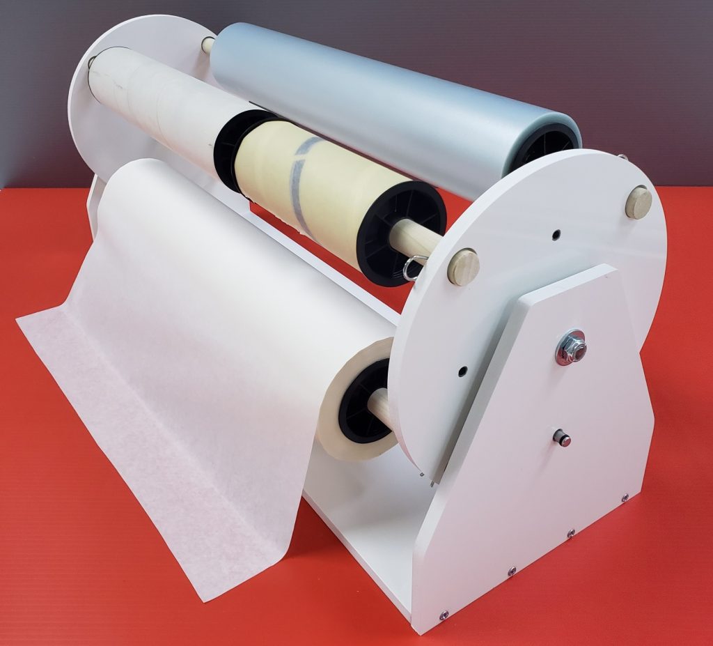

weyandsign
I have the weber one, and also a homemade one using a boom handle thru the tape roll, mounted between 2x4's with holes drilled in them. They both work the same.
DL Signs
Never go against the family
Had a couple of those Webermade dispensers years ago, was going to get one for here but they're discontinued :(

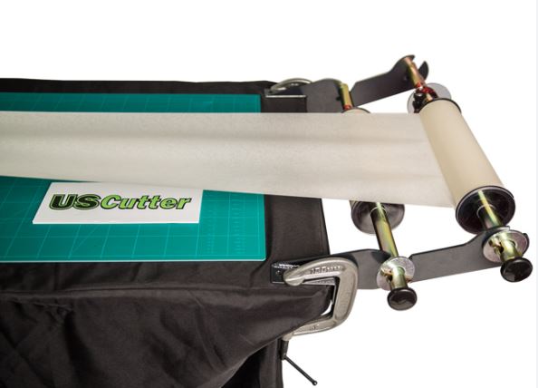

cmoist
We have a few of these. They work just fine - better if you attached them to the table. I like that they are closer to the table than some homemade versions Ive seen.
Signarama Jockey
I have one of these. Not terrible, but once you see it you realize that you could have made it yourself and saved the money. Still. We use it every single day.
