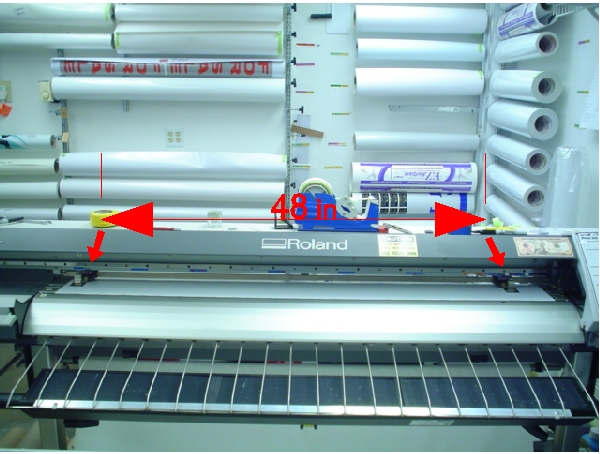

I have worked with this for a week or so and I am wondering if what
I am doing is the best solution. I set up the printer for an offset 47"
print on the 54" material- see pict. That seems to be the only way to
get the roland registration marks to line up with where the GX-500 has
to have the marks. Is there a better way? Thanks Gene
