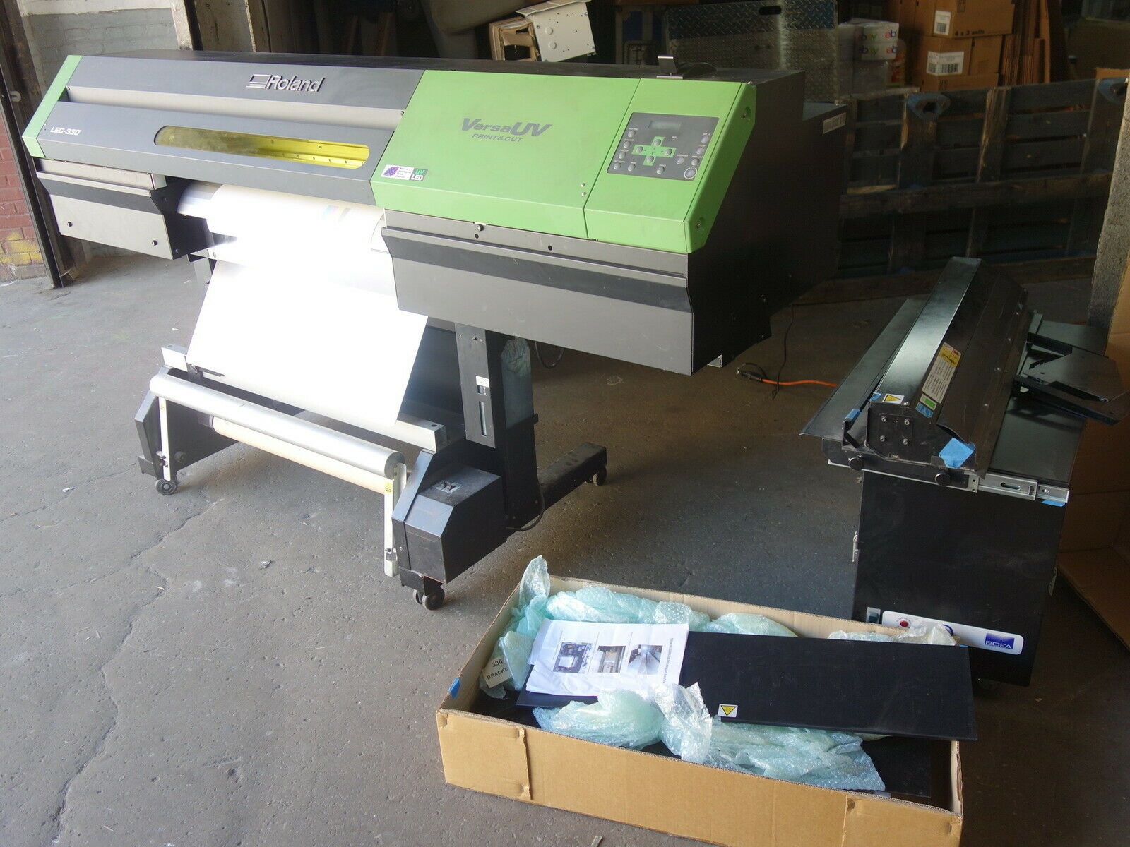

Hi I recently purchased a Roland LEC-330 from someone that didn’t know much about the machine and have some questions that I would like to ask you if you could PM me or send me a text message to my cell 813-922-1579.
I’m wanting answers about the different Roll and Rigid Media I can print on, How to load and setup Rigid Media in the LEC-330 and what settings you use with the Gloss and White Inks.

Rigid media, that doesn’t flex, will need the rigid media brackets to be technically be safe. BUT, you can level tables in front and back to replicate if needed.
The data sheet for this model lets you know your thickness limitations. It’s pretty much thick cardstock max on this model, the carriage doesn’t raise any higher than a solvent does. The LEJ has the height changing option.
This is much more of a vinyl / film printer than anything else. It’s really limited by that head height.
