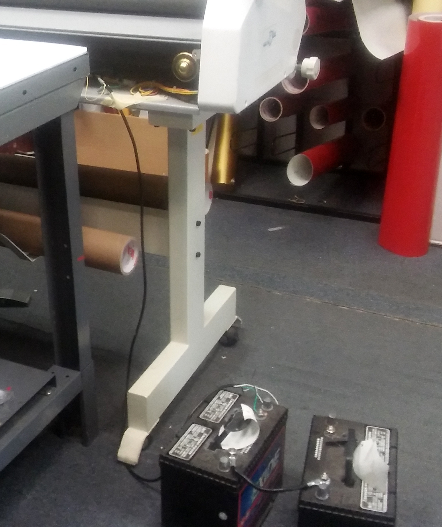

This is where I am at with this now. The motor works. The photo sensors appear to be lighting properly. The relays are clear and you can see them working and hear them clicking. I checked all of the cable connections over for anything that may be loose. Right now I have the 36v motor hooked to 24v batteries and it laminates perfectly (as long as my co-worker holds the wire to the battery, that is the on/off switch). Still trying to figure out what the program is. I don't want a tech to just come and tell me to replace the whole pcb, but at this point I am out of ideas for this. 2017-02-21 07.31.52.jpg

So it all works when you bypass the on/off switch for the laminator? Maybe the on/off switch is bad? You have an ohmmeter? That's my only guess at this point.
