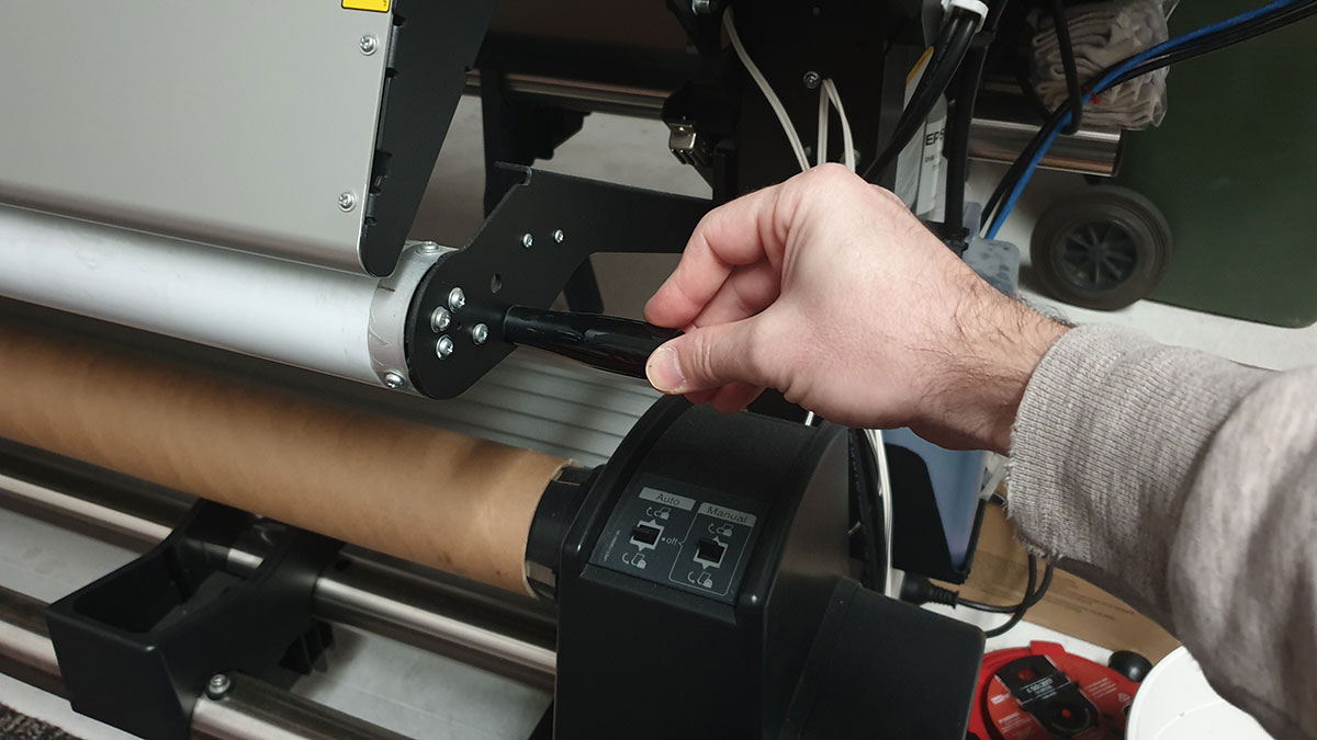

Are you moving the dancer bar down to activate the auto take-up?
Push this downwards once media is loaded and taped to the take-up roll.

I believe the take up motor plugs into the printer somewhere, was that overlooked?
Also make sure nothing is interfering with the dancer bar, I've had it hit a roll of vinyl in front of the machine and not activate.

It has to know there is vinyl on there (so some has to be loaded and locked down).
It has to be plugged in, and the "auto" switches on the end have to be set up to the correct rotations.
It is activated by the bar being in the correct range of motion.
Should work then.

The take up is plugged into the back of the printer underneath a cover.one day our printed freaked out and didn't he substrate calibration wrong.... We came back after lunch to 10-20 ft of media unrolled on the floor, and the take up reel not working.
We took it apart... And the plug is not held in very strong, the loose vinyl unplugged it.
Very easy fix.... When we called our tech about it he said the takeupreel must be broken and we'd have to buy another one. So even though this is too late for you, hopefully it'll help someone else!
