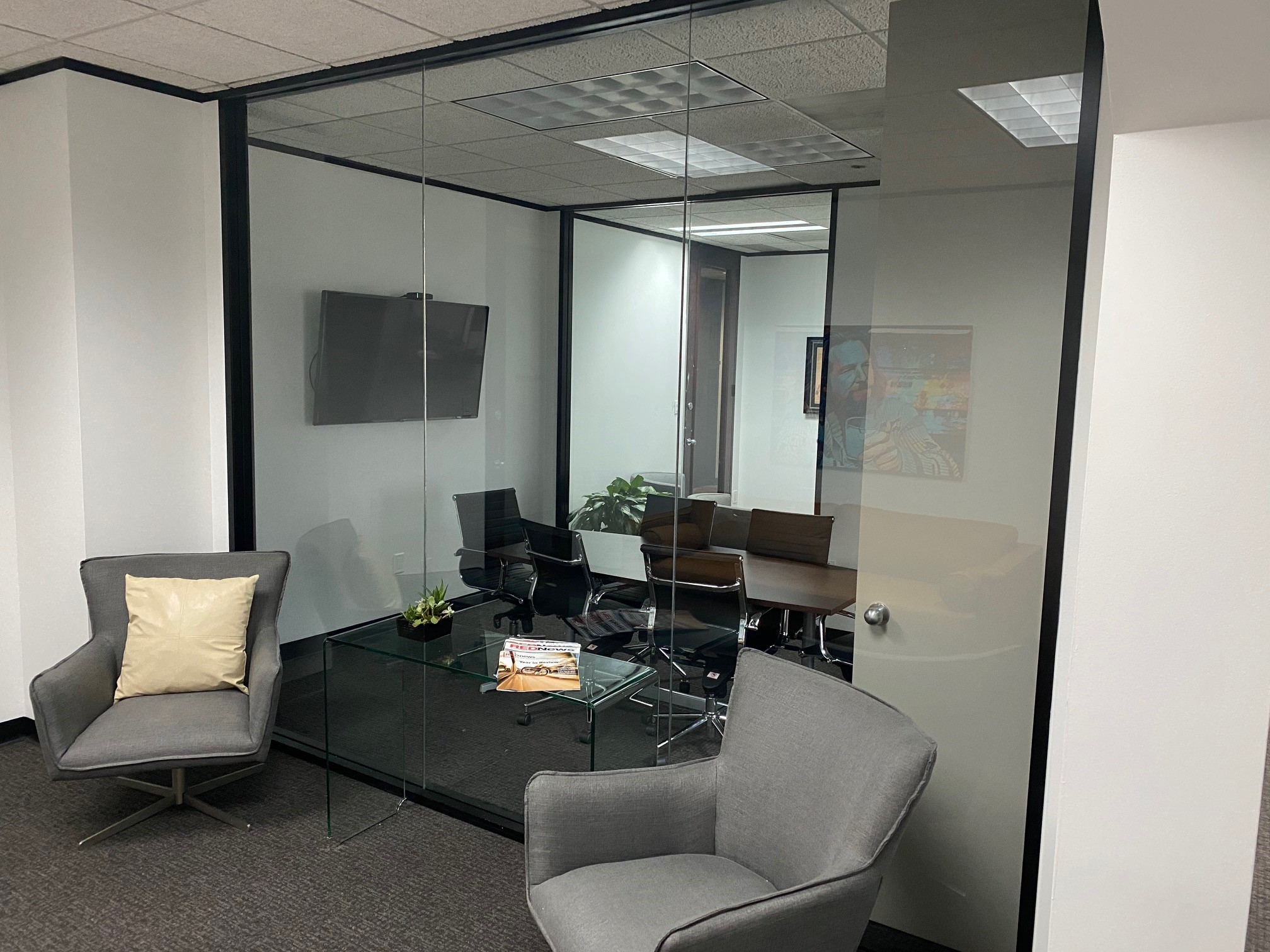

I'm the one doing it. and the window is a wall of windows separating a conference room and an entrance into the office.
