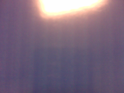

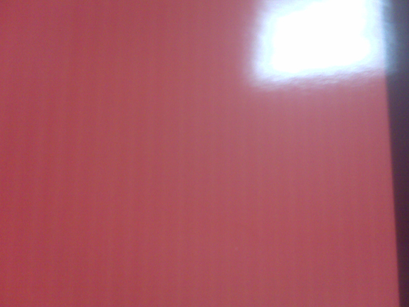

speedmedia
Here is a pic although it isn't great. It is from my phone. I can take a digital pic if you aren't able to view this well enough.
Thanks,
Kurt
