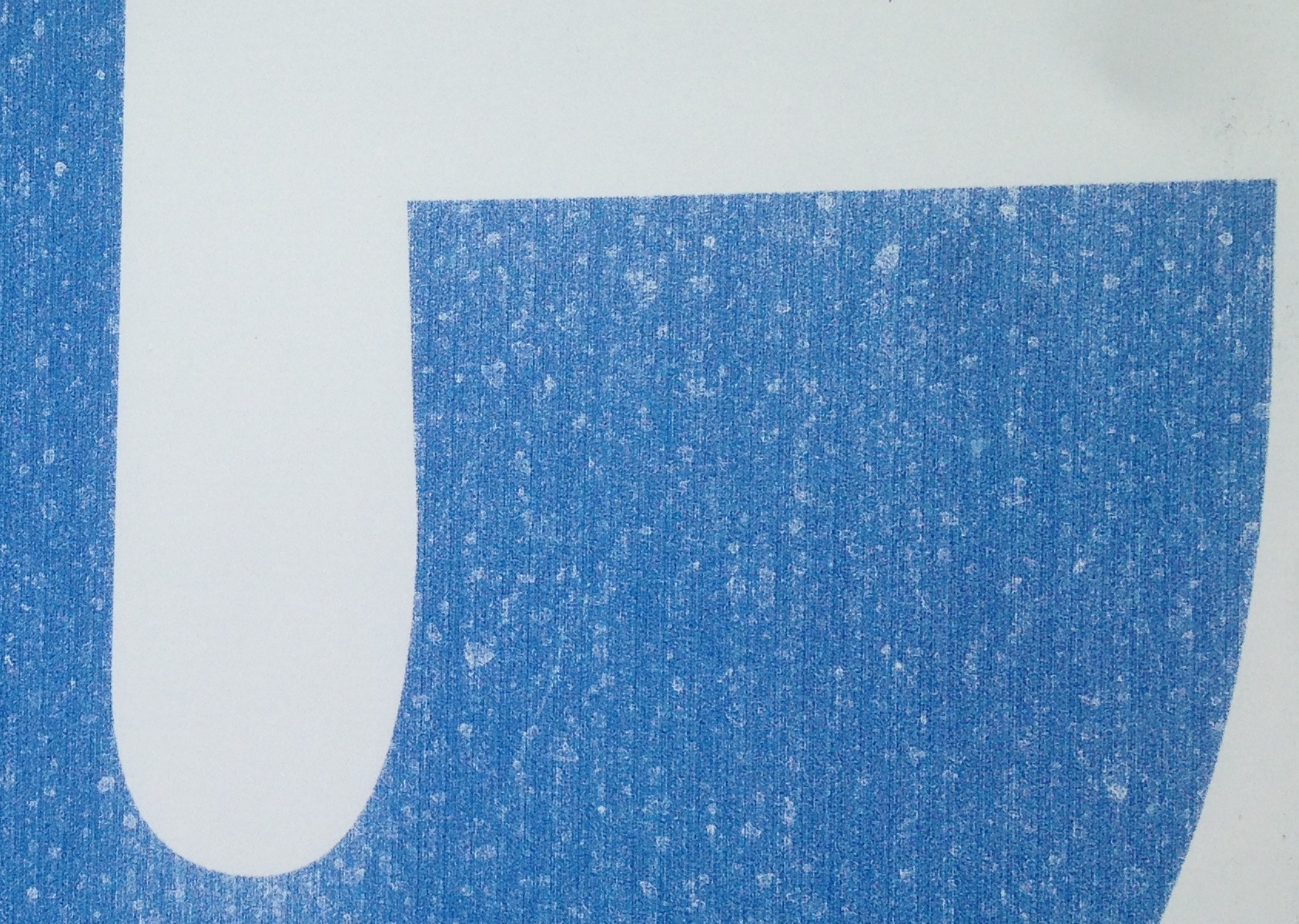

I was called in to replace the sign vinyl for a small company. I got there with our new prints and the vinyl that had been installed looked like it was 3m (and based on the smell of the adhesive. With a little heat it pulled up nice and easy.
BUT, the printing was horrible on it. They told me it had been installed 3-4 years ago (late 2014 I think) and it looked really bad. This happened to be the good side not facing the sun. It is not cut vinyl.
Not only did the colors completely fade but it just looks really strange. Another local sign place did this but I just could not believe how bad the printing was. Next, the ink would smear right off with your fingers, without trying much.
I believe it was printed on a Roland because that is what the other company that is near us has (and they told us who made it). Would that be 3rd party inks?
This was not laminated but we have also not laminated certain jobs and have never had anything look like this.
Is this normal for something that is not that old?
