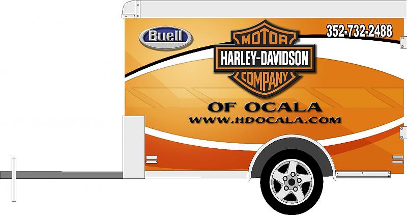

i have some banding going on in the orange mainly. i have the correct profile , set to standard, bidirectional, etc. here is the proof, i can get some actual pics later. printing out of flexi on sp300v?? thanks for any help

Are you at 720 or 1440?
The gradient setting at 256 or better?..Makes a huge file when you up the fountain fill steps..but may give you what you need..

yep been doing that for a while, still looks about the same but not too bad so i printed it..thanks

Hard to say without seeing pics, but lowering the temps may eliminate some of the banding on a color like orange.
