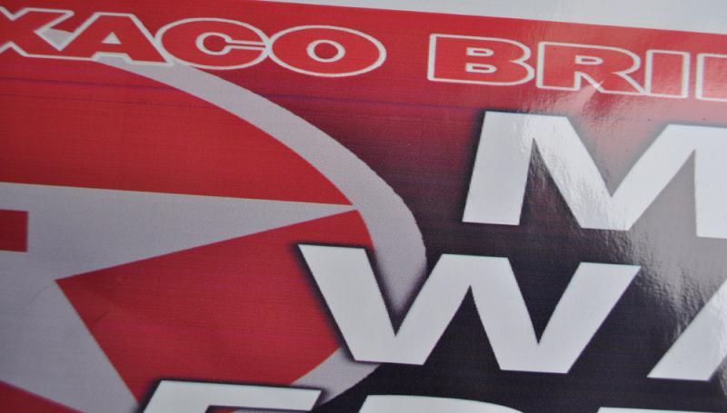

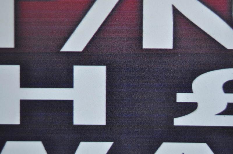

Starting having this problem about 2 weeks now..
Started with banding and has developed into bad streaking.
This is more noticeable with black areas, it will start printing black on the first pass and magenta on the second pass but the magenta is not consistently being layed down on some passes and seems like black drops out.
This leaves the black area with red/magenta streaks.
It will do this through out the print and as you can imagine its a streaky mess..
Other problem is cross contamination with the cyan/yellow head. printing solid yellow will have cyan lines for almost every 2nd pass along the yellow and when i run a nozzle print the cyan/yellow or yellow/cyan will mix between each other. Seems to be at the top of the head and nowhere else. Cleans take this away but returns when printing starts but not in a consistent manner.
The lines are free of any ink as i do a disway wash every evening before i leave for home.
I was reading about cracked heads between the 2 channels, could this be the case and the head still operating ok, i have had no head crashes.
Printer is jv3160s
New pumps about 4 months ago
New dampers fitted yesterday
3 New heads November 2012
running flexisign 6 pass.
Any help appreciated..

If I remember the cyan and yellow are on the same head.
If so I can only see this as a cross contamination or a head beginning to fail.
I would replace the cap and check the pump is running correctly.
If this still persists I would suspect a head is going bad.
