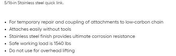

This is for a 5/16" quick link, probably too big to even use in a grommet, and while it's capacity is far beyond a banner, it still says not for overhead lifting.
I'm not trying to tell you it's a bad idea, or discourage you from using them, it just bothers me that the less professional folks around my region will hang anything from S hooks and walk away. I'm quick to add cost for shackles and the like.
