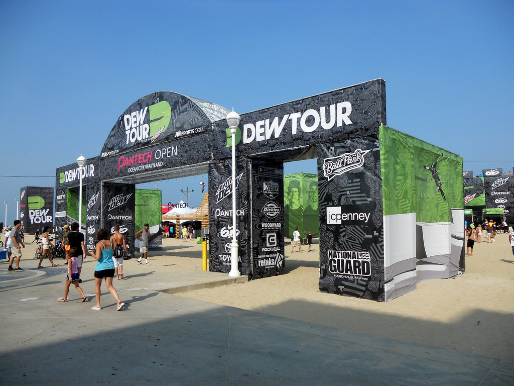

"Truss structure" can mean a lot of things... some of which can change recommendations.
Got a pic?
datoshway
Sure thing. See attached example.

JTBoh
I sell signage and signage accessories.
I'd use banner or flex, maybe mesh.
Sewn hems are an absolute necessity. May even need webbing sewn in.
Looks like the method of attachment is tarp bungees. In order to tension, make sure grommet holes are inset enough from edge (using wider hem) to pull the material in. Personally - I wouldn't print anything without full assembly and measurements, all existing material, OR a manufacturer supplied template.
Beaches are windy places... I dont think a fabric will hold up as well. Canvas would be prohibitively expensive as would 4 way stretch spandex.

Yeah, unless the person installing it has expience wrapping the trusses, it's not going to be fun. Coro would be best for newbies.

We've used a lot of regular old 13oz banner with grommets for this type of project. The main issue we've had is that no one can work a tape measure correctly.

I don't understand using coro for this. I feel like thats going to be a sloppy mess.
Nah, looks good. Especially when you match your ties to the printed coro. I wish I could remember the name of the company that sets up the trusses for most of the major races in the southeast.

Are you able to visit the structure while it's fully assembled or can you get old panels to replicate?
As for material, don't use canvas or mesh. 13oz vinyl is just right. Maybe 15oz. Some 9oz dye sub poly with hook and loop seams with sewn hems if you're frisky.

Stretch with grommets sounds like you would have issues when the wind hits it. I think the "stretch banner" is for the tradeshow backdrop stuff where stuff gets stretched over lightweight frames.
For outdoor stuff like this you're gonna want to just use regular old 13oz banner; whatever's cheapest or on sale currently. ;)
