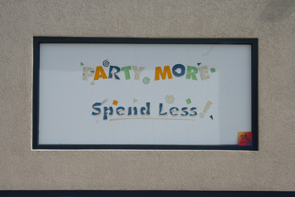

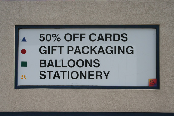

I have a job coming up that needs the removal of old graphics. This vinyl appears have have been on for at least 7-10 years. It is baked on and cracking. Any suggestions of the quickest and easiest way to remove? Thanks in advance. Attached are photos.

what is the substrate? is it glass? wood? plastic? how big is that? once we have the info, it will be easier to give you some help.
MrDesignGuy
Sorry guys, hectic day here... forgot the particulars. These are glass windows. Two are sized at 103" x 43" and the other at 91" x 43". So fairly large. I'm not sure if a vinyl zapper would damage the glass or not. Have not really used one before. I figured just old fashioned elbow grease with a razor blade or lil chisler would take 10 years to remove. Is there a solvent similar to rapid remover that can be used to dissolve old vinyl??? It would be ideal to spray on, leave for 30 mins to an hour, come back and wipe clean. Thanks again.

If this is regular green or tempered glass... a window razor scraper will do the trick.... and I might add very quickly. Glass is the easiest thing to clean. That size will be about 10 to 15 minutes a window with no chemicals or magic potions.

Just get a 3in scraper and Rapid Remover and get the job done......It shouldn't take you more than 15min to do both those windows.......

Use a long handle razor scraper.
Clean the grit off the glass and spray it down so your razor scraper glides easily.
Should take no time at all.
GAC05
Quit buggin' me
Like Mike said spray the window down with whatever solution you end up with and keep it wet as you work. If you scrape the vinyl off dry with a razor it is pretty easy to scratch the glass.
