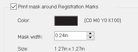

how do you print the reverse reg mark?
Cutting master 4 has the option.
It turns it into this - Much more accurate for reflective materials

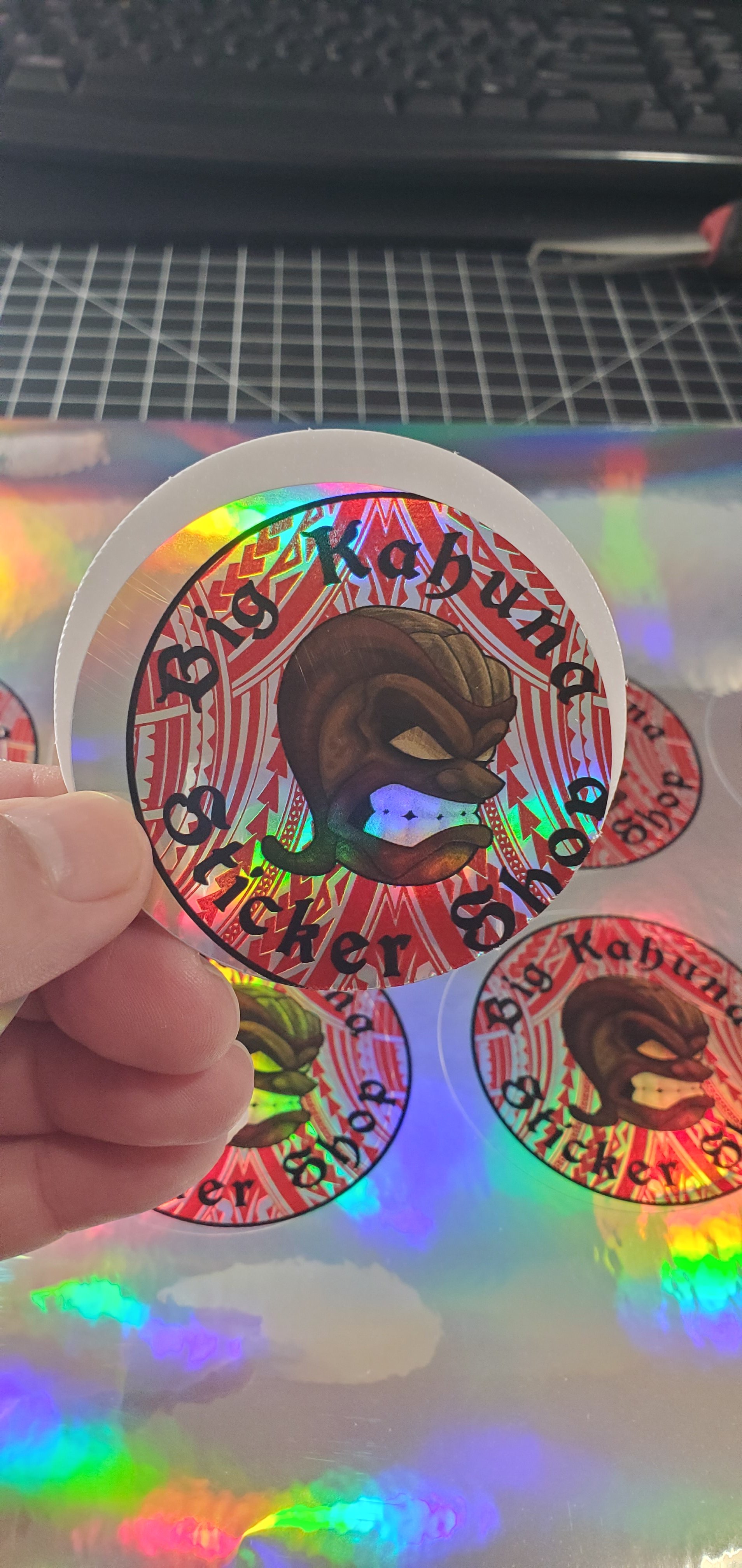

my fc8600 wont cut holographic for anything lol trying to purchase the fc9000 but i use flexi and no option to do that :(
Have you tried the reverse marks? I use it on my 8600 and it cuts holo pretty good.
Or if you're in a bind you can put premask over and use a felt pen.
