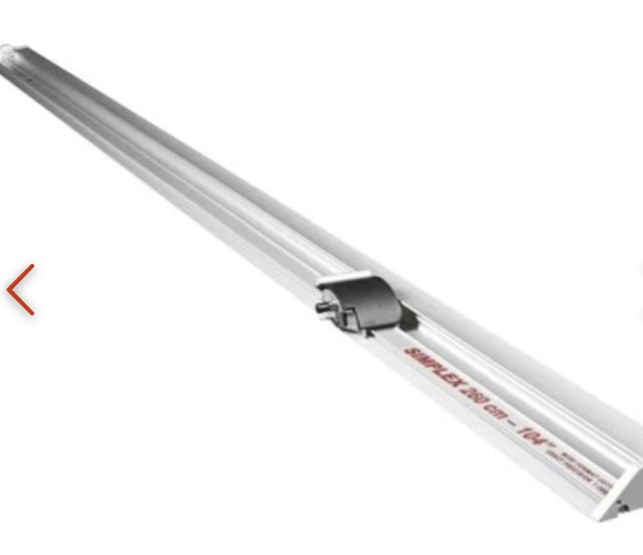

A step up from ruler/knife would be something like a keencut

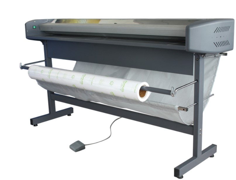

a step up from that would something like Royal Sovereign Electric Trimmer
A step up from that would be a flatbed cutter
I have a keencut. I cut faster with knife and ruler. Did not use it for 2-3 years now.
The royal sovereign electric trimmer is cool. I played a couples hours with it and did not like the inaccuracy. I have a fotoba digitrim, but it does not work for this application.
