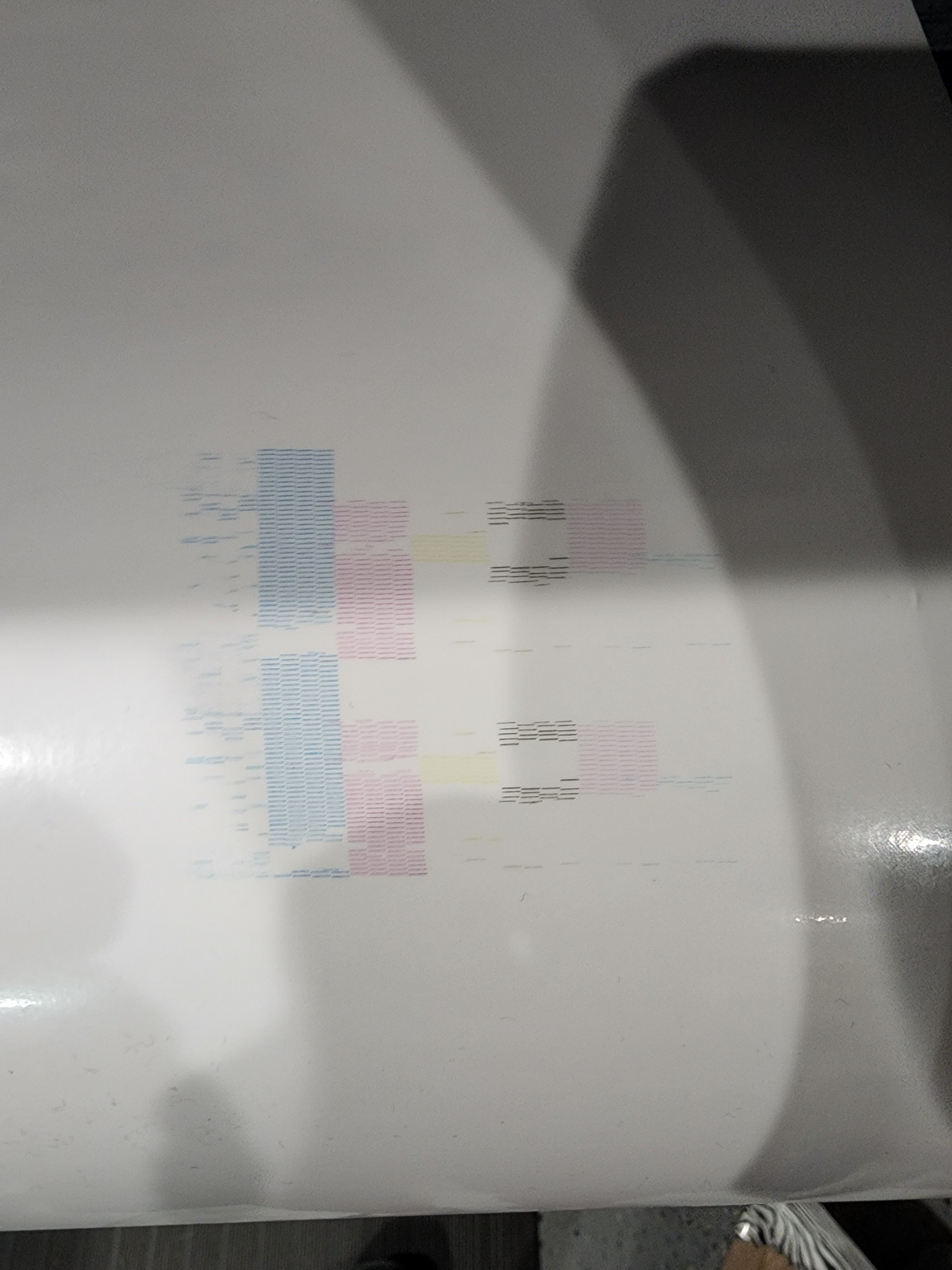

Right now C and M are printing fine, Y and K are having problems. Not sure what the next step is. Y was fine when K went out. Now Y and K are only partially getting a good test print
binki
Here is the test print after changing the wiper, felt and cap top. The printer was working fine about 10 days ago. All of this started after a head clean. I have the white ink option but have cleaning carts in for white for the last 3 or more years.
Any thoughts here?
