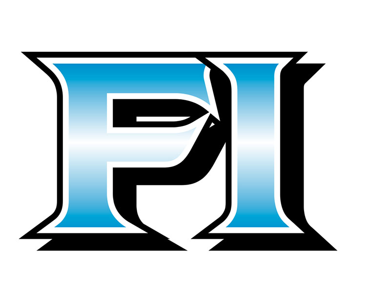

Hi fellas, does anyone know how could I make this shadow on Illustrator CC 2017?
I usually copy and paste the logo and move a little down, but this way I can't have the outline and the edges don't follow the perspective. Thanks a lot!

bannertime
Add gradient to the initial layer. Add white stroke attribute, set it behind the fill attribute. Copy layer, add the initial black stroke to create the thin portion of the outline. Expand and merge it to make one piece. Copy it. Change it's position to create the thicker portion of the outline. Select both black shapes and then use the Blend/Blend Options to fill in the gaps between the two positions. It takes about 30 seconds and creates a pretty flat file. End up with only two layers. The gradient text with white outline and the black shadow.
Edit: Here's a little screen cap of the process. Been awhile since I've done this. I typically have an action setup for this procedure. Near the end when I undo some of the process, I redid the options with 60 steps instead of 24. If it's something I'm going to contour cut, I might just merge the two layers without the Blend and just delete points to create the straight line. If it's just a quick print job, then I just do enough steps to make it look clean.
Marcio Gomes
Worked out! I don't know if I missed something but I had to rasterize and image trace the black shadows to make the edges straight. Anyway, I accomplished the task. Thanks man!

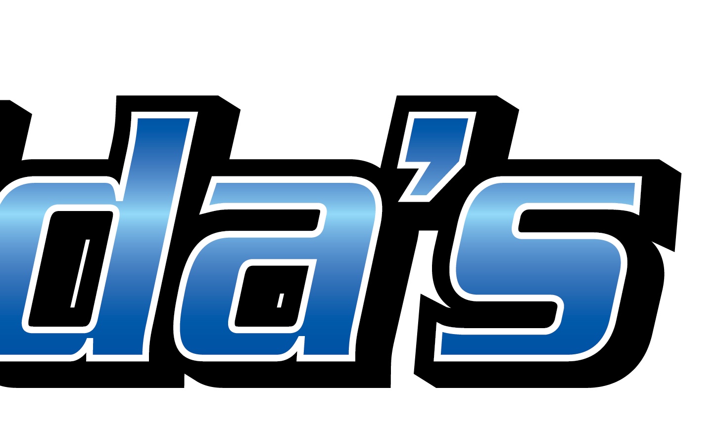

Johnny Best
Like others explained..
Illustrator
type letters, outline
gradient
object/path/offset white
object/path/offset/black
copy black and drag for dropshade
pathfinder/unite black outline and dropshade

Marcio Gomes

Marcio Gomes
Illustrator
gradient
Yo Johnny, did you the straight line in the I's shadow, that's what I wanted to have in a perspective. Anyway, thanks for your help. Now I have three different ways to learn more. Best!
