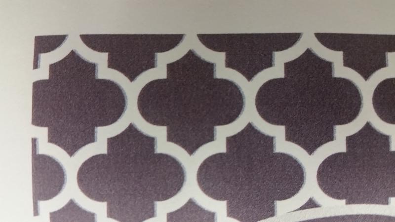

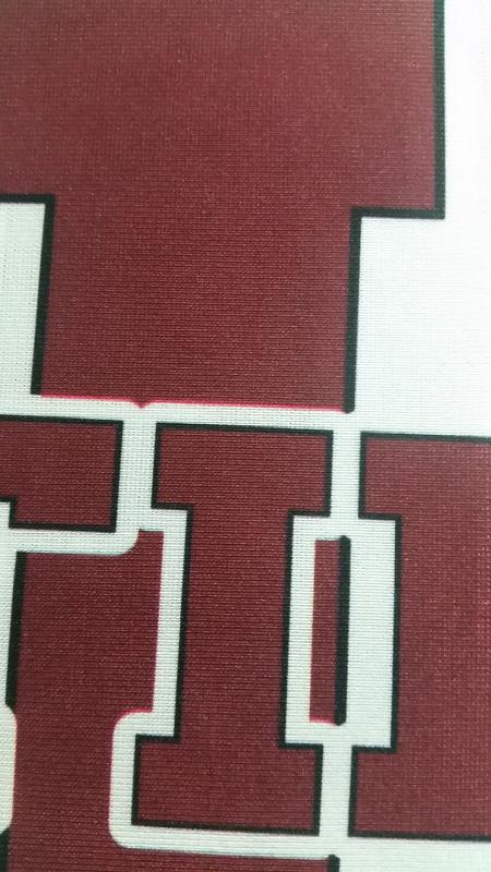

1. Can some one give me an idea what might be causing this? At first I was getting this the cyan was bleeding over on this print.
2. I did a horizontal test print. The magenta was fuzzy. Long story short the had was blown. I changed the head lined very direction back up now this. Now the Magenta is bleeding over and I have lined the heads up.
Any suggestions.

Did you run the alignments in the Service mode including the mechanical adjustments or just the user adjustments in the regular menu? If you didn't run the mechanical alignments, your electronic ones will be off no matter what.
JMSports
Rechecked Alignment
I'm trying to go by the manual. I'll check it again.
Thanks
I rechecked the alignment. I miss one little thing. Works great. I will not miss that again. You learn by your mistakes.
