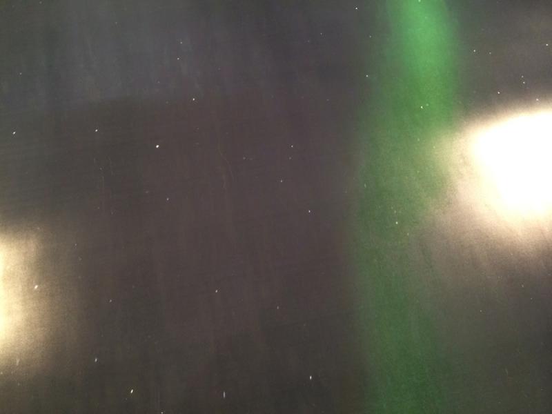

Isas plastics are very hard to profile, ink limits and restrictions need to be perfect.  For plastics 16 pass will be the minimum for solid colors.  You might need 20.  But the most important part is your ink limits.  Print the  ink limit patch but make the patch big so you can look for the banding in the solid colors and limit where banding doesn't exist.  Also restrict your lights as much as you can, I would make them zero.
